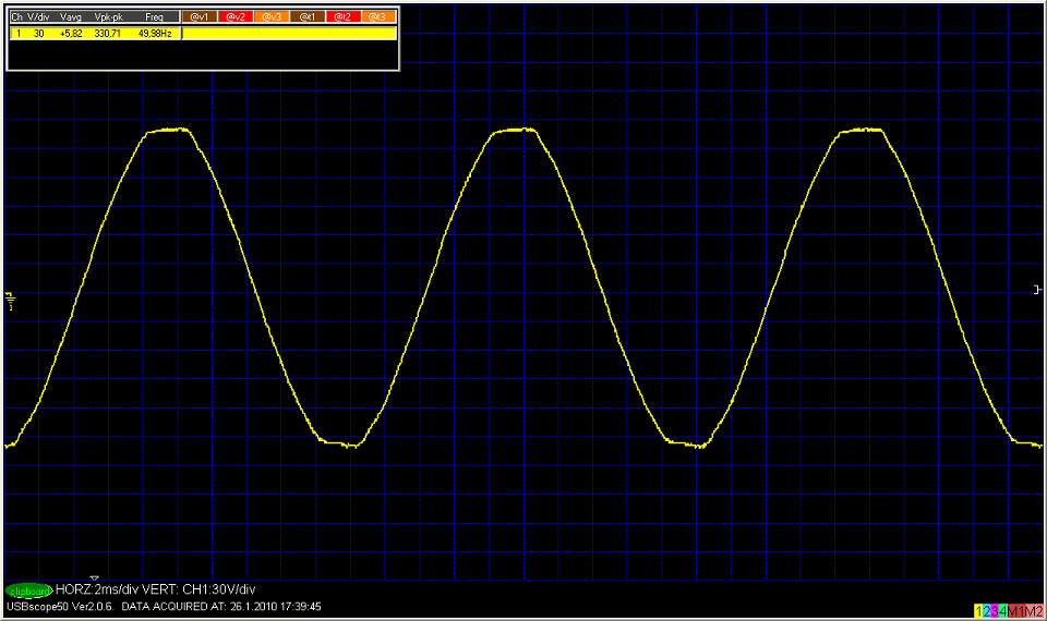

Is there really DC on the AC power lines?
How easy to answer. Evening shot of my power line (with 1:2 divider):

Okay ruin my fun.

DC does appear on the power line, usually from a nonlinear rectified load (a light bulb with a diode in series to dim it for example). This causes residual magnetizing currents in transformers etc. making them buzz and have higher harmonic distortion.
Distortion doesn't simply add OR subtract. (Some people have proposed measuring the residual THD of an analyzer and removing that from the measured distortion to arrive at real distortion- it doesn't work.) At low levels the phase and amplitudes of harmonics and add or even cancel, usually only at the specific measurement conditions. Never so nice for music.
