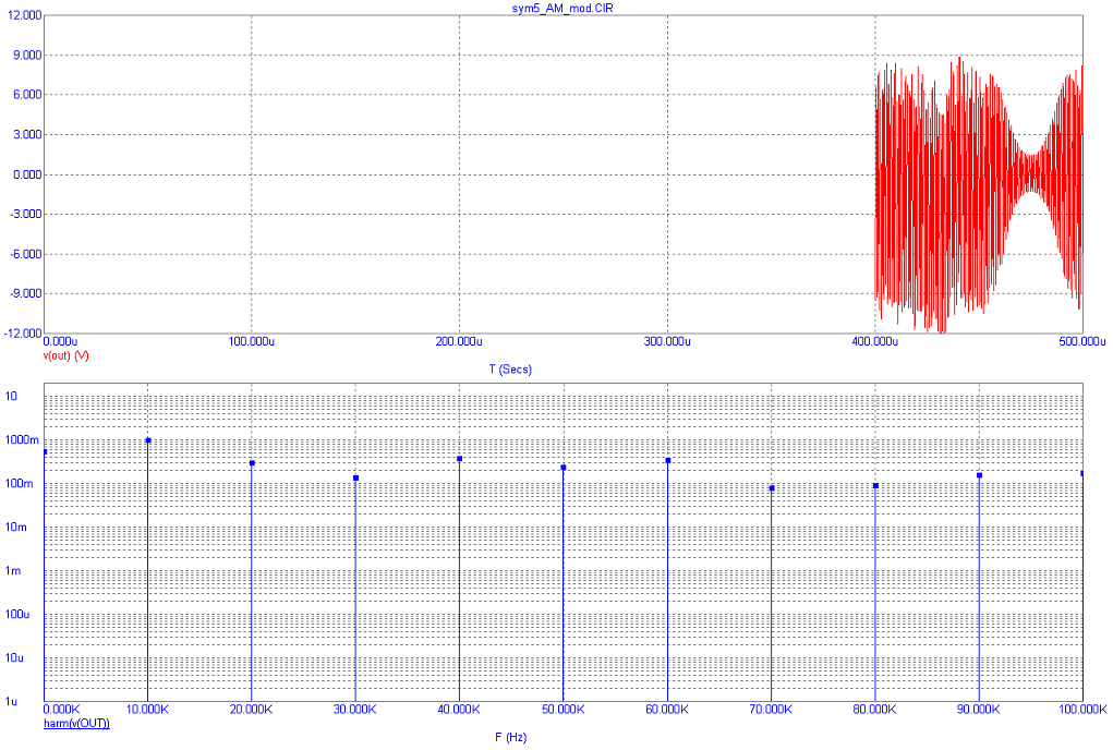

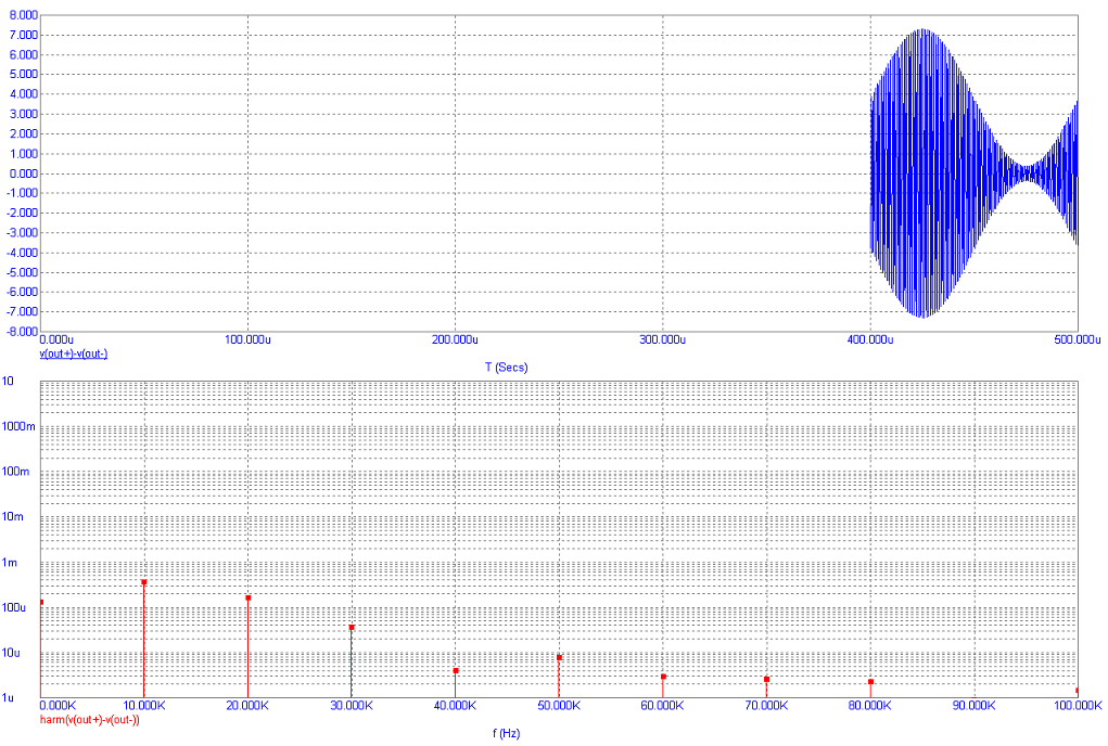

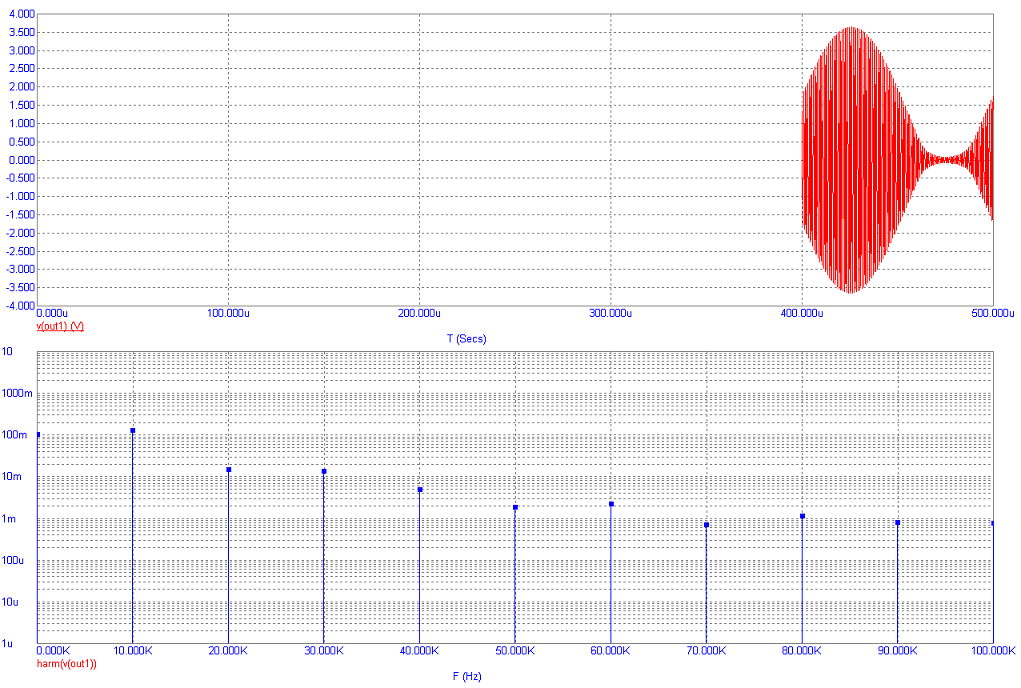

have you tried susceptibility of audio amplifiers to AM modulated or FM modulated high frequency carrier, with Hewlett-Packard AM/FM modulation generator or similar instrumentation.
Thanks for your replies to my question. I would like to show simulated results of AM modulated input to 3 very different power amplifier topologies.
1 is All Mosfet, no global feedback, complementary-differential input amplifier with balanced output.
2 is complementary-differential JFET input amplifier with BJT output, single-ended.
3 is a very traditional, All-BJT design with simple differential input and single-ended output.
Input signal was a 1MHz carrier AM modulated at 90% by 10kHz. 1Vpeak amplitude for amplifiers 1 and 2, reduced to 500mVpeak for amplifier 3. Results are attached. For input amplitude reduced to 100mV, the order of influence of AM modulated input remains unchanged, amplifier 1 is best and 3 is worst. Images from left to right: Amplifier 3, amplifier 2, amplifier 1.
