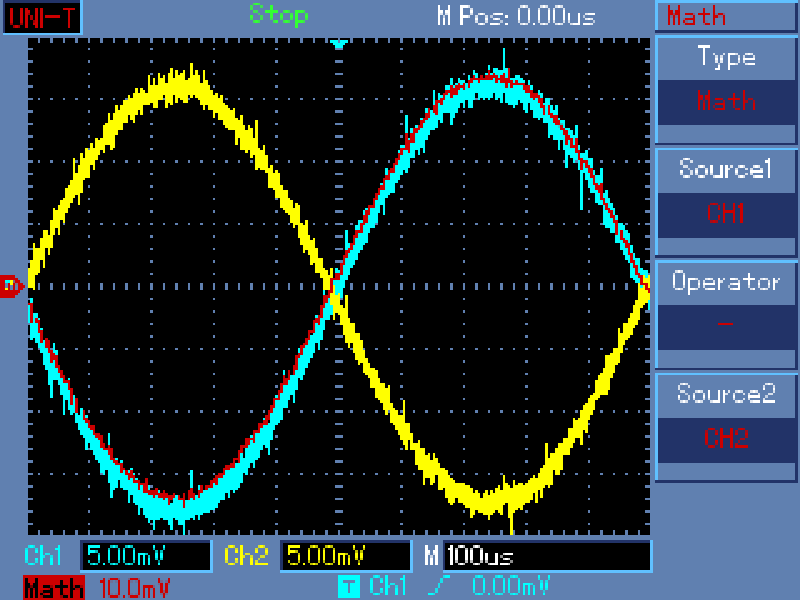

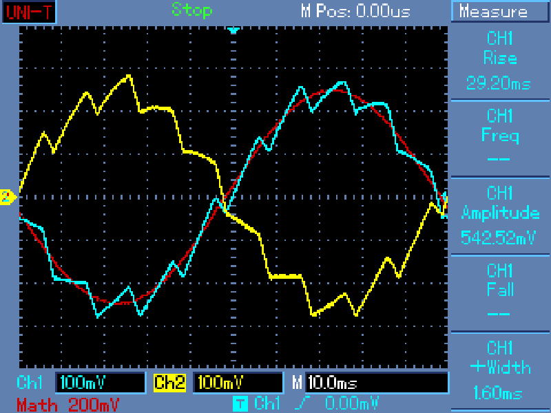

BTW, there is one circuit topology of the power amplifier that is excellent in suppression of power rails supply noise, pls see attached image. Output is the red line.
