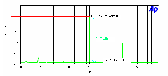

Edit: I did find the answer to my question. So the fundamental is again at 15.81V. But you still didn't describe the measurement procedure. I give up.
Let's see. The first plot shows the fundamental at around -92dBr and the noise floor at about -176dBr, or about -84dB down from 15.81V. So in volts the noise floor would be at 15.81/10^(84-20) = 0.0009975V, or about 997.5 uV. Sounds kind of high for an AP unit. Have I made a mistake?
No -176 from 15.81 volts is 10 exp (-15.81/20)*15.81 or 1.58e-09*15.81 or 2.5nV
As to the test method it has already been covered.
This I would agree. But the picture shows the noise floor at approximately 84dB lower than the fundamental, not at 176dB.
