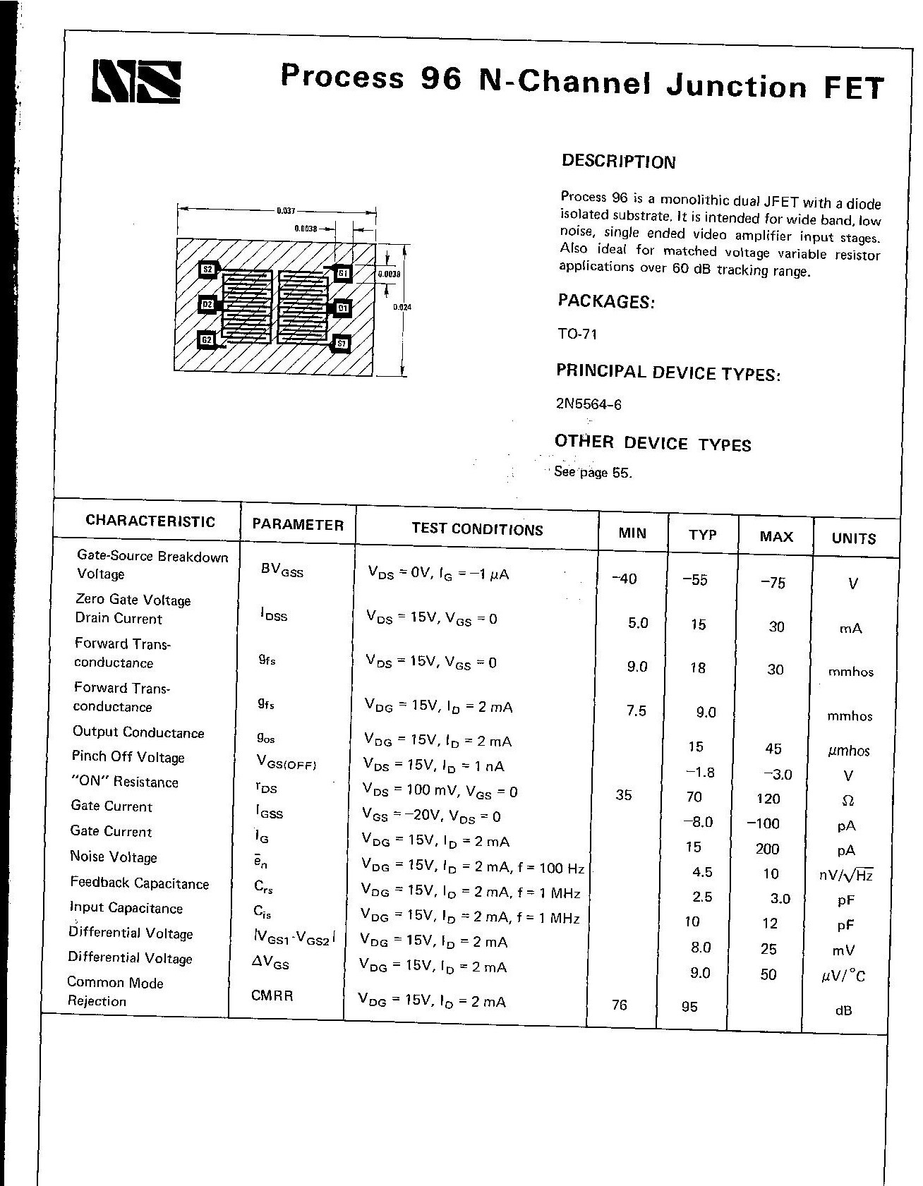

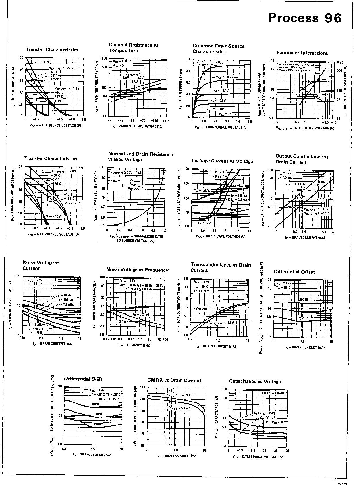

process 96 (5564 et al.)
From an old and very battered National Semiconductor databook, before they stopped showing characteristic curves and then exited the discretes business altogether. Interestingly, this is a dual that has no really close counterpart as a single. The transconductance to input capacitance ratio is very good for those days, and the highish breakdown voltages are handy.
