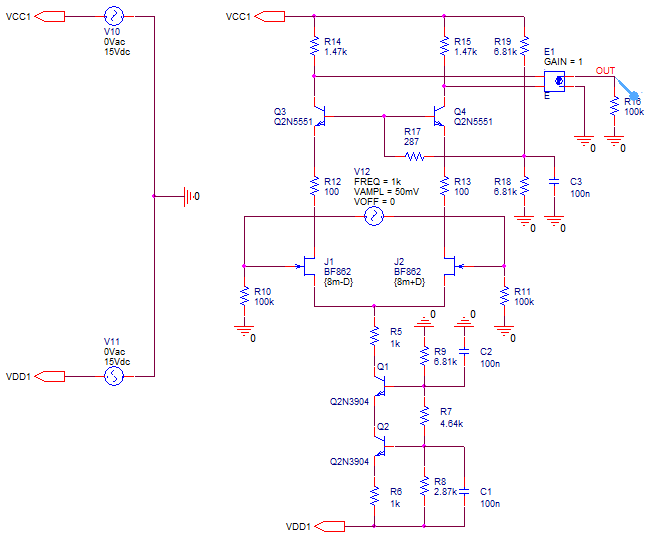

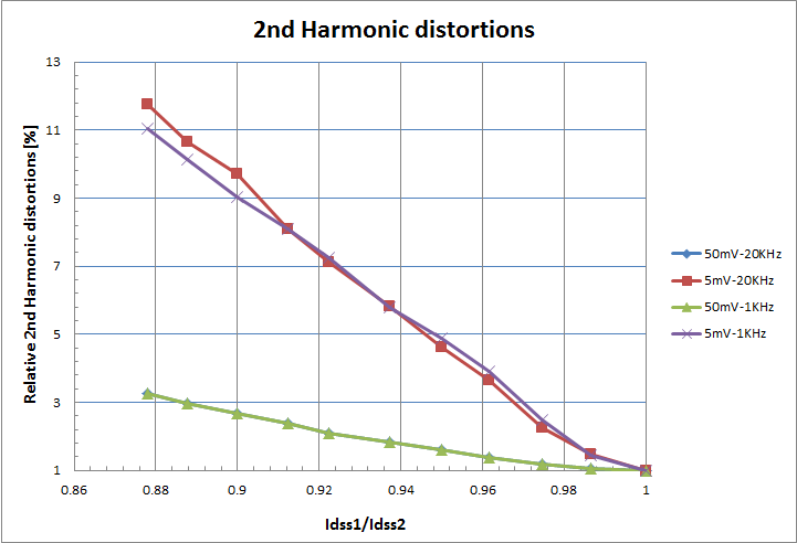

Here's some data to support my "distortion cancellation with 10% matched n-ch is an illusion" statement.
I took Mr. Cordell's jfet input stage, exactly as depicted in his VinylTrak article, used the NXP BF862 model (parametrized by Idss) and simulated the 2nd harmonic distortions (2HD) as a function of the Idss mismatch. The schematic and the simulation results are attached. In all cases, the 3rd harmonic is much lover than the second, and all other higher harmonics are virtually zero. So the 2HD pretty much defines the THD.
- There is very little relative 2HD frequency dependency in the audio band. I tried 1KHz and 20KHz, and the results are virtually identical.
- 2HD increase very quickly with the Idss mismatch.
- Ideal matching absolute 2HD were 0.25% for 50mV input at both 1KHz and 20KHz and 0.0047% and 0.0066% for 5mV input at 1KHz and 20KHz respectively.
- Taking the 0.9 Idss mismatch as a reference (it's the guaranteed Idss mismatch in the LSK389/489 data sheet) the 50mV 2HD increases by a factor of 2.8, while the 5mV 2HD increases by a factor of 9-10.
Conclusions:
- 2HD cancellation requires very close Idss matching. A 0.9 Idss ratio (as guaranteed by the much sought after monolithic dual jfets) is not good enough.
- Either a minimum 2HD is a critical design requirements (and then much closer matching, perhaps to 1%, is required), or the 2HD is considered low enough, anyway below the audible threshold, and then paying a premium for monolithic duals is useless.
Now, given these results, somebody please explain to a poor EE student why should one pay for the expensive dual monolithic. Modern devices from the same tube (or, even better, dual chip devices, which are always picked from neighbour locations on the wafer) are not far from the dual monolithic devices matching. Also the absolute distortion levels @5mV are already lower than the vinyl plus cartridge distortions, with or without device matching.
Conclusions:

Bear in mind that what matters in the symmetrical operation of a differential pair is the matching of the transconductances at the operating currents of the two devices. Those operating currents are usually maintained to be the same. Even with a 10% mismatch in gm, you will still get about 90% of the benefit of the cancellation of even order nonlinearity, which is certainly a lot more than an illusion.
Thus, it is wrong to assume that a 10% difference in Idss will imply a 10% difference in gm at a given operating current. The latter mismatch will typically be much less.
I did not say that. I simulated a 10% Idss mismatch, not a 10% Gm mismatch. Gm~SQRT(Id*Idss), the Gm ratio stands as the square root of Idss's (since the operating currents are the same), so a 10% Gm mismatch would have a 3 times larger impact than a 10% Idss mismatch.
In practice, the devices in a dual part may be much closer than 90%. I believe much of what you are maintaining from a practical perspective is related to this. However, I think you agree that relying on better than data sheet parameters is not good engineering practice.
Transconductance matching at a given operating current is not necessarily the same as saying that Idss of the two devices is the same. Indeed, transconductance at a given current in a JFET depends on Beta, the transconductance coefficient of the JFET, not Idss. We have, gm = 2 * SQRT(Beta * Id). For a given transconductance parameter Beta, gm is largely independent of Idss and Vt, and goes up as the square root of drain current.
I suppose I'm missing here something. Beta is an intrinsic parameter of the device. FWIW, the designer doesn't care about the grueling details like carrier mobility, channel length/width ratio, etc... and relies on simple equations like the one I quoted above, tying transconductance to the static operating point and the external electrical parameters. Another version is Gm=2*Idss/Vp - I think saying that Gm is independent on both Idss and Vp is a stretch. At least two quantities of the Beta, Idss, Vp triplet are independent and must be specified.
Again, I did not say that, see above. The simulation results are based on Idss mismatching, hence (being a rather theoretical approach) a three times lower Gm mismatch.
