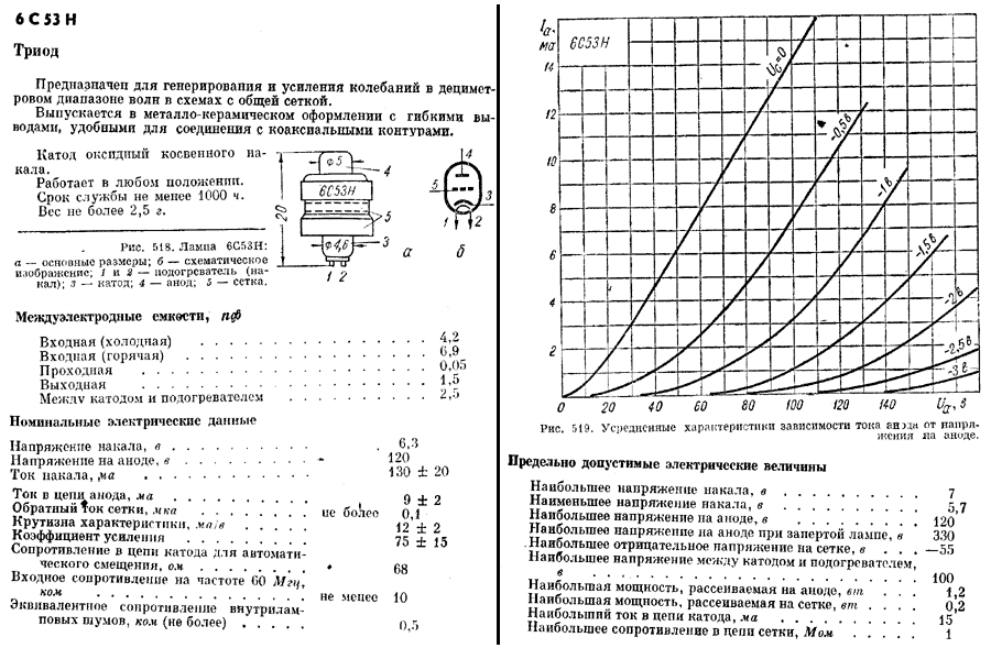

I'm not certain that even the Russians still make them so prices are creeping ever higher.
As far as I know, Nuvistors were not made in the factories that are part of New Sensor's joint venture now. The factory, that made them, did not survive the Russian "grab whatever you can" boom.
George, how do you like this beast? S=12 mA/V, u=75! 😎

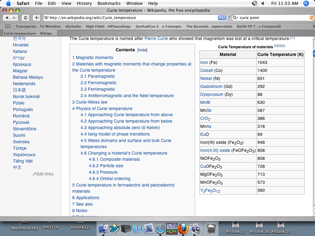

The quickest way to increase the distortion of a low level transformer is some DC leakage in the primary or secondary. Actually demagnetizing the transformer is important if it may have been magnetized for some reason. That requires driving the transformer to saturation and then reducing the drive to zero.
That's not a technique familiar to me. We use damped sinusoids, where peak would be saturation. Or, just go over curie.
This relates to the all too common problem with toroid power transformers and blowing fuses. Often the transformer had power removed while the current was at a peak. That leaves the core saturated and the inductance close to zero. Translates to a short (primary DCR) on powerup and the resultant current (100's of amps) popping the fuse.
Magnetic saturation is typically in the 1.2 to 1.5 tesla range for lots of core material. Coercivity of good magnet steel is typically in the 80 A/m range, after exposure to >10,000 A/m.
The remnant field isn't anywhere near saturation, but more than 2 orders of magnitude down.
