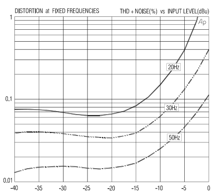

Can anybody comment on the flat spot through zero crossing of the B-H curve? Is this real and if so doesn't it mean that transformers introduce some "crossover distortion" (or at least are not monotonic)? Frank McIntosh mentioned this in his amplifier papers before I was born, in the context of output transformers, so it's not new ("audiophile") stuff.
I would think that would result in a rather dramatic rise in distortion at lower and lower levels, much like with an amplifier in class B. Can't say I've ever seen anything that bares that out.
Here's a plot of distortion at fixed frequencies versus input level for a 1:10 microphone transformer. There is a slight rise as level goes down, but looking at the 50Hz plot, it starts trending back down again.
Those two comments seem to fit together. I'm wondering if it would be a good idea to use some DC bias current with small signal transformers. Not enough to get near saturation, but enough to move the operating range away from that "crossover" area. Something like the way SET output transformers are used.However, there are other things about transformers that many people overlook, and even ignore. They can increase in distortion at lower output levels in the bass.
I dunno. I haven't done much listening to transformers as such. However based on the enthusiasm with which tiny effects are embraced among some, I thought it worth a mention. I'm sure it is very materials-sensitive in any event.But does Barkhausen noise rise to the level of audiblity in a good quality transformer?
If it were audible, I'd guess it would only be with extremely low level signals, such as the output of a moving coil phono cartridge. But then I'd also guess it would likely be pretty well swamped by the record's surface noise.
