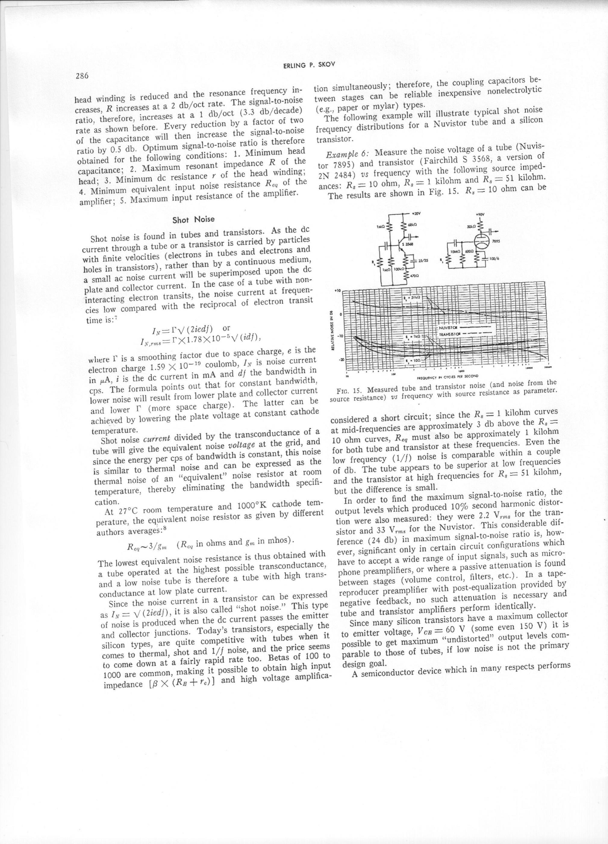

Tubes will ALWAYS have more voltage noise than the best solid state. It is probably a matter of operating temperature, as well as Gm. Transformers are a necessary 'evil' for power amps, and a useful step up device for phono or mike stages.
This is a page from an AES paper from Erling Skov from the early '60's. One of the best papers on the subject I have ever found.

For those folks too young to have been raised on the Big Red Bible (Radiotron 4), "shot noise" was used to mean thermal/Johnson/Nyquist noise in vacuum valves, and calculated as the noise of a resistor of 1/gm at 1000 K (although not expressed exactly that way - they used a 2.5 multiplier). Modern use of the term "shot noise" is a statistical thing, arising from the quantized nature of charge. What Brad has discovered for us is the interconnection of the two. Very cool stuff. Must have been out there all along but I never knew it.
The 'official line' is that shot noise is not thermal/Johnson/Nyquist noise but genuine shot noise - the statistical thing - but smoothed by the cathode space charge. In the early days of valves it was thought for a while that the noise was thermal noise from the anode resistance, and people argued about it. Eventually it was agreed that it was not thermal.
However, in calculating the space charge smoothing factor the term in 'e' (the charge on the electron) disappears and a kT appears so it begins to look a bit thermal. In a noise diode there is no smoothing so the 2eI remains untouched and pure shot noise can be experienced.
The 'resistor' (i.e. equivalent thermal noise) arises because it is convenient to refer the noise to the grid input circuit. Before this is done the expression for noise power has a gm in the numerator. Referring to the grid circuit means dividing by gm^2 (as we are talking power) so we end up with gm in the denominator. The 2.5 on top is an approximation which is roughly true for many valves.
So the gm originally on top comes from the noise generation and smoothing mechanism. The gm^2 on the bottom is stage gain, when referring anode noise to the grid. If we could somehow separate these two different appearances of gm then equivalent noise resistance would not vary like 1/gm but gm(noise)/gm(gain)^2. Exactly this happens in a valve RF mixer: the gm on top stays as gm and is set by the valve bias etc, while the gm on the bottom becomes gc (conversion transconductance) which is roughly proportional to local oscillator voltage level. So we get 2.5gm/gc^2, which in my view contains more useful information and is more accurate than the usual 4/gc which the textbooks quote for a valve mixer.
Please excuse this little diversion into valve RF design!
