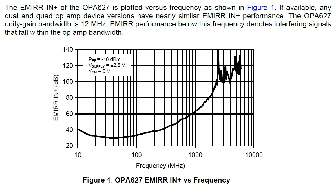

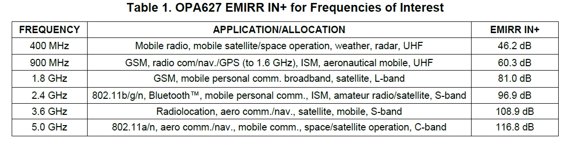

Like this?
EMI Rejection Ratio (EMIRR)
The electromagnetic interference (EMI) rejection ratio, or EMIRR, describes the EMI immunity of operational amplifiers. An adverse effect that is common to many op amps is a change in the offset voltage as a result of RF signal rectification. An op amp that is more efficient at rejecting this change in offset as a result of EMI has a higher EMIRR and is quantified by a decibel value.
View attachment EMIRR OPA627 sboz016a.pdf
EMIRR vs frequency
EMIRR frequencies of Interest
sub uV rectified EMI audio band effects can usually be treated the same as in noise sensitivity analysis
It is decisive for opamp 'sound quality'. The higher the dv/dt at Vdiff, the higher the issue and then we separate "slow" designs from "fast" ones and exponential transfer functions from another, less curved. This should be discussed, and not THD of 0.000003% as per datasheets.
