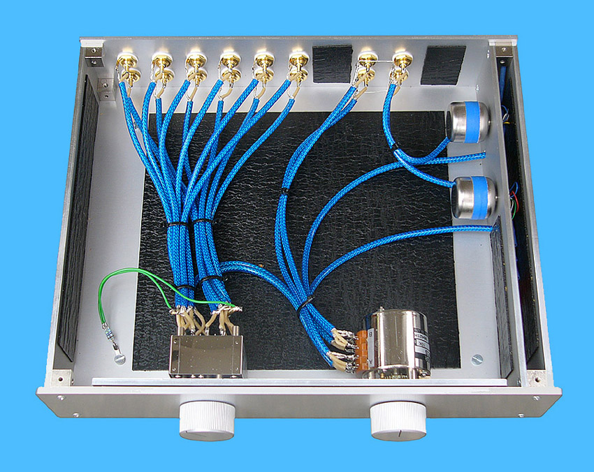

and a bad passive design would have AC in the BOX John? I have not seen such a device ... are you expecting a significant piezoelectric effect from such an expensive switch? if not what other effect might a small amount of vibration cause in a large passive control? and how exactly does selected areas of damping material on some of the flat surfaces alone, prevent this effect?
you must have different meanings for the words clean and direct over there in the USA? how else would you wire up a control of this type? apart from, more directly...
as discussed, the fact they are not bundled means there is more likelyhood of ground loops because it makes a more effective aerial and coax/foil will do nothing to avoid EMI
John Curl said:
IF I can get a constructive word in to this discussion: Let's see what is GOOD about this passive design.
First: No AC in the Box
Second: Thick walls with added damping.
Third, Clean, direct design with first class volume control and pretty good looking switch.
Four:Wires are separated and not bundled.
If I had not worked on the Blowtorch project, I would have prefered a passive preamp much like this one.

The wiring on John's example is unnecessarily long. Put a GSM phone near it when it's searching for a tower and let me know what you hear. Most amps have the token "RF filter" with some lame 0.01 uF cap but really have never tested it.

you could at least post a decent example for us to discuss, several better ones have since been posted over this somewhat inept version which has only shiny parts going for it. I can only find fault with that one and weve all had our say, now its simply boring and dare I say; trolling... to post it again. what possible positive outcome is there to post it again, you dont like this person? hes a competitor?
I think its a pretty bland comment and does not speak in favor of you at all, you sometimes disagree with yourself.. since when do a bunch of opinionated people agree totally about everything? can you really have so little experience with the human race that this amuses you and makes you feel somehow better than when this occurs? then again I suppose the thread has moved on a few pages overnight and it could use being reaffirmed.
I thought we all (except for you) had pretty consistently come down against it for pretty similar reasons, what is it we didnt agree about? many see that a well executed passive preamp has its place in some systems, myself I dont use any analogue sources these days so it has no place for me, but the Weiss is a nice use of technology and is rather pretty without enough extra wire to make another 9 of them. the other examples are orders of magnitude more sophisticated than this one above
