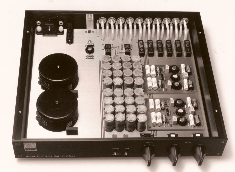

Now, SE let us look at your design. Unity gain, is it?
Yes.
Why all the caps, trying to impress somebody? Toroids? ICK!
I must confess that at the time I designed that over 20 years ago, I allowed myself to be swayed a bit by the prevailing "audiophile" wisdom. That multiple small caps in parallel were better than a single large value cap and that toroid power transformers were the greatest thing since sliced bread. Many of the "listening contest winners" at the time were doing the same things.
Standard power supply bridges?
Yup. I found them to work and sound just fine.

Great. So why don't you comment on something that hasn't been out of production for over 20 years. I posted a current schematic some posts back. Comment on that if you'd like. It would at least have some relevance to today.

I'll have to go back and read the Aunt Corey article. Corey lived in Austin and was a buddy of a buddy. My buddy, who worked at the local hi-end shop, created his own version that uses a massive toroid and telecomm relays. I bought one from him and it's still in my setup to this day.

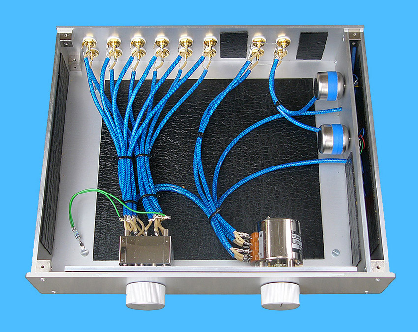

IF I can get a constructive word in to this discussion: Let's see what is GOOD about this passive design.
First: No AC in the Box
Second: Thick walls with added damping.
Third, Clean, direct design with first class volume control and pretty good looking switch.
Four:Wires are separated and not bundled.
If I had not worked on the Blowtorch project, I would have prefered a passive preamp much like this one.
