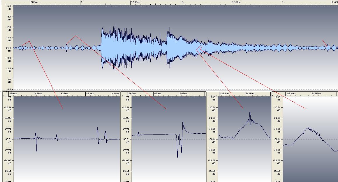

Like Wadia, based on pretty looking output with some undesireble frequency content. In this case the frequency domain artifacts are very limited by minimizing the fix up window which is almost always the case.
For example 2msec ~.025" wide pop OUCH!
Thin and shallow scratches are in the 40-80us. Thick and deep ~ x2-3 of that. Debris and dirt ~ x5 but have the highest amplitude, thus cause high dV/dt.
Below are some light to moderate scratches (the far right image shows groove wall damage)

Hmmm, how do you figure that? IIRC that means a ninth order polynomial fit. As you see in George's first pics there is essentially no frequency content in the region of the pops so a third order b spline is nearly perfect.
