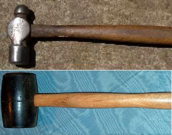

I understand that you approach is more cautious than mine (my method can be called “spline reforming” 😀 ).
I would like to ask you if you have tried to apply dither after spline interpolator treatment, your version and/or all the software you tried.
The worst are the frequency domain fixers which don't work very well on an essentially time domain problem.
True and spot on! (SY will come and point that this frequency/time domain mismatch is false :headbash: ).
My understanding is that “judgment and observation of the user” sets some criteria which are flexible and variable (click and pop wave shapes are really multishape), to the extend that it is difficult for now to be encoded in an algorithm.
