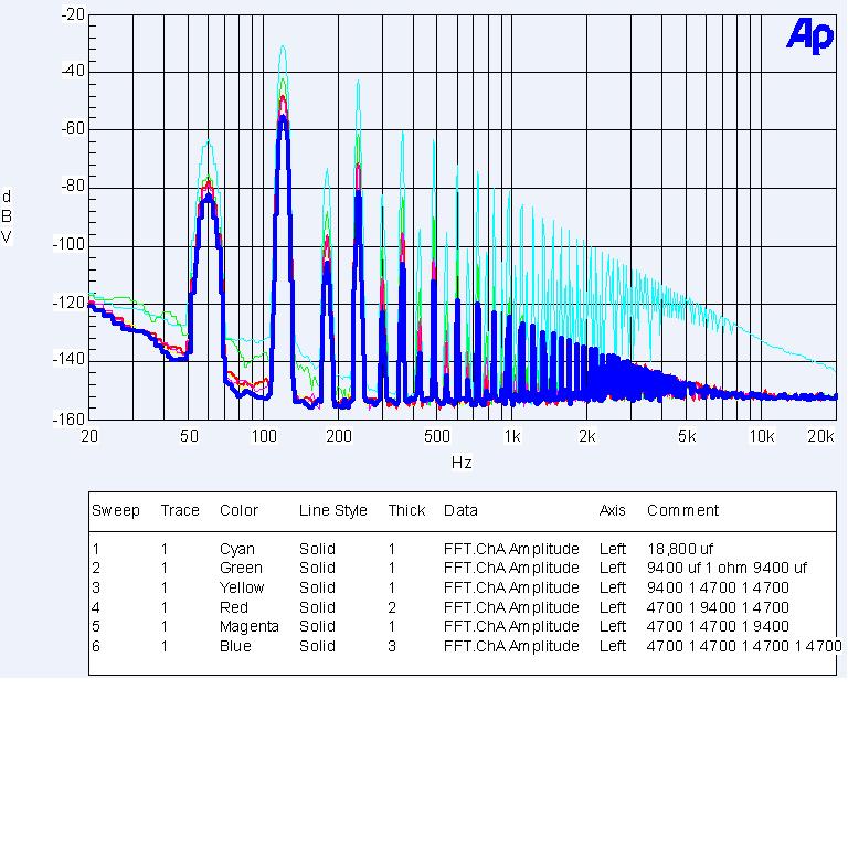

I am using my worst transformer and diodes while exploring the filter network!
Even so the 60 hz is 108 db down from the DC output.
ES
How do you define this?
60Hz component is -64dbV (0,63mV) to –82dbV (0.08mV)
http://www.diyaudio.com/forums/attachments/analog-line-level/337613d1363896759-john-curls-blowtorch-preamplifier-part-ii-4-stages-stage.jpg
120Hz component is -30dbV (31.6mV) for cyan to –56dbV (1.6mV) for blue
180Hz component is -76dbV (0.16mV) >> to –104dbV (0.006mV) >>
240Hz component is -42dbV (7.9mV) >> to –80dbV (0.1mV) >>
480Hz component is -64dbV (0.6mV) >> to –102dbV (0.008mV) >>
Above this freq, peaks drop at 40db/decade (12db/oct).
For cyan, LF rectification components will increase 10-12 db more than HF components when psu is loaded dynamically.

60 Hz best case is .08 mV ripple, agreed, the DC voltage output is 16.25 Vdc so my eyeball of -108 db was wrong it is only -106.15 db!
However it is still a bit noisy for a preamp circuit. -56 db ripple @ 120 into a PSSR of -95 db with a gain of 60 db would give .03 mV of ripple or more than -90 dbm of 120 hz. since my noise floor should run around -134, just using CRC filters are a hard way to get there unless someone goes for CRCRCRCRCRCRCRCRCRC!
Now that filter would have around 20% voltage loss. Of course a 7815 needs 2 volts across it for a 13% loss. I will go for three CR stages into a regulator. The regulator works well below 2,000 hz and the filters do in most of that before it gets to the regulator. As real regulators can do 45 db, all that remains of concern is ringing under load. Of course this is all from a clean AC line, so the transformer EMI pass through and diode noise will come into play.

What's the likely current draw of a 60dB gain stage?
15 mA each preamp or .35A for 24
Hello,
Have you tried 2 half wave rectifiers rather than a bridge?
It goes against convention but it maintains a balance for +/-
Referenced to ground.
A CT ground depends on the wiring more.

A bit back in this thread I outlined most of the issues I am addressing. That is one of them.
