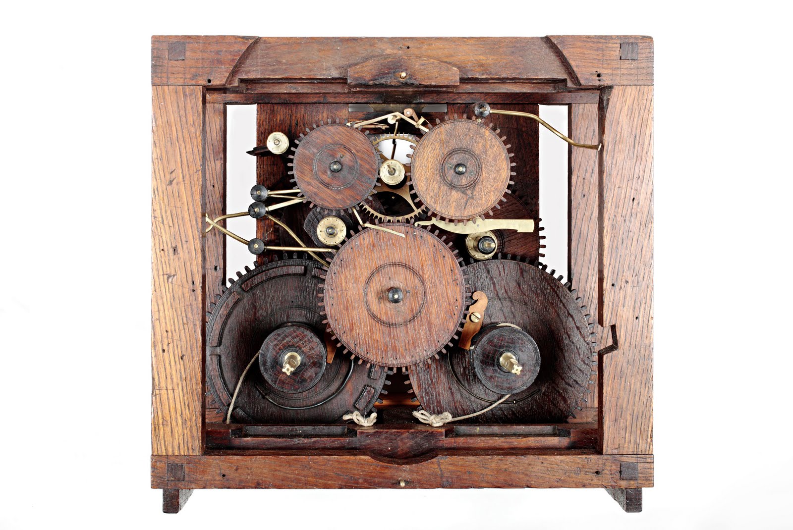

I thought you were building one of these. Its on a par with what you do for your day job. Its still running which is a good indication of the life expectancy of wooden gears. He did not have access to a multi-axis CNC machine, or even a router. Just lots of time and patience.
Well, I don't make wooden clocks or use milling machines, but it seems kind of 'decadent' doesn't it? I mean, do they keep better time? Of course not, but I will not criticize your wanting to put YOUR time, effort, and money into it.

Very nice, color me green. What's interesting is that Harrison was also a carpenter, he built wooden clocks. H1 apparently has wooden gears even though he used lignum v rollers on the pinions for reduced friction. Anyone at the observatory, take the tour of the clocks. Then gentleman who gave the talk when I was there was so awesome, and really knew his stuff.
Those are exactly the type of gears I'm fixing on occasion. If you look top center, the escape wheel is brass, the pallets are probably steel hardened at the tips. Lower left the count wheel is built onto the weight mandrel. Time side is the right side of the mechanism.jn:
edit: ah, just noticed the link name is harrison. Cool. It looks like the teeth are actually dowels inserted in the gear wheel edges. They are too thin to survive if the grain cut across the teeth.
One issue I come up with on occasion is the teeth may not have been created using an indexing plate. When I put in a section of new teeth, I have to eyeball the new tooth profile...a 36 tooth gear's teeth may deviate from 10 degrees by almost a degree or two, requiring finess. Not having finess, I make do..😀
What amazed me the most is the level of technology achieved in the 1600's and 1700's, Invar was developed in 1750's I recall, as a consequence of temp dependence. I have a book called this modern clock, written 1905, it is still dead on the money.

First, they are a part of history. Man's use of available materials and thinking to measure time. The research in bettering time spun off huge benefits for man. Harrison's work saved countless lives at sea. I recommend the book Longitude.
Second, learning this stuff is an enrichment. Teaching a 12 year old how to fully disassemble and reassemble an 8 day mantel clock is in itself rewarding. While he may never do it again, he learned some new skills and confidence. We ALL should be instilling that in the next generations...
At the turn of the century, they were already making clocks which were 5 millisecond accurate per day, in an age when there was no such thing as a room thermostat...that is technology. (I've no idea how they proved that accuracy back then)
That is why I do not criticize you for wanting to put effort into audio. The goals, while different, are also the same.
