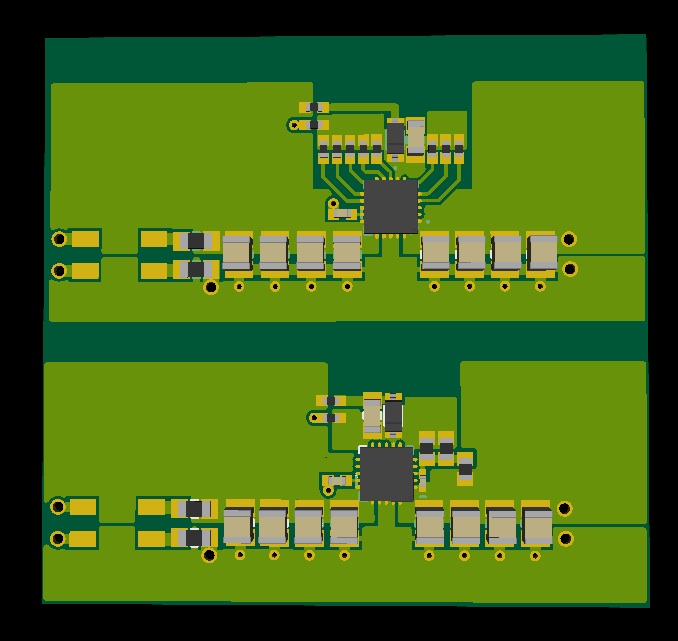

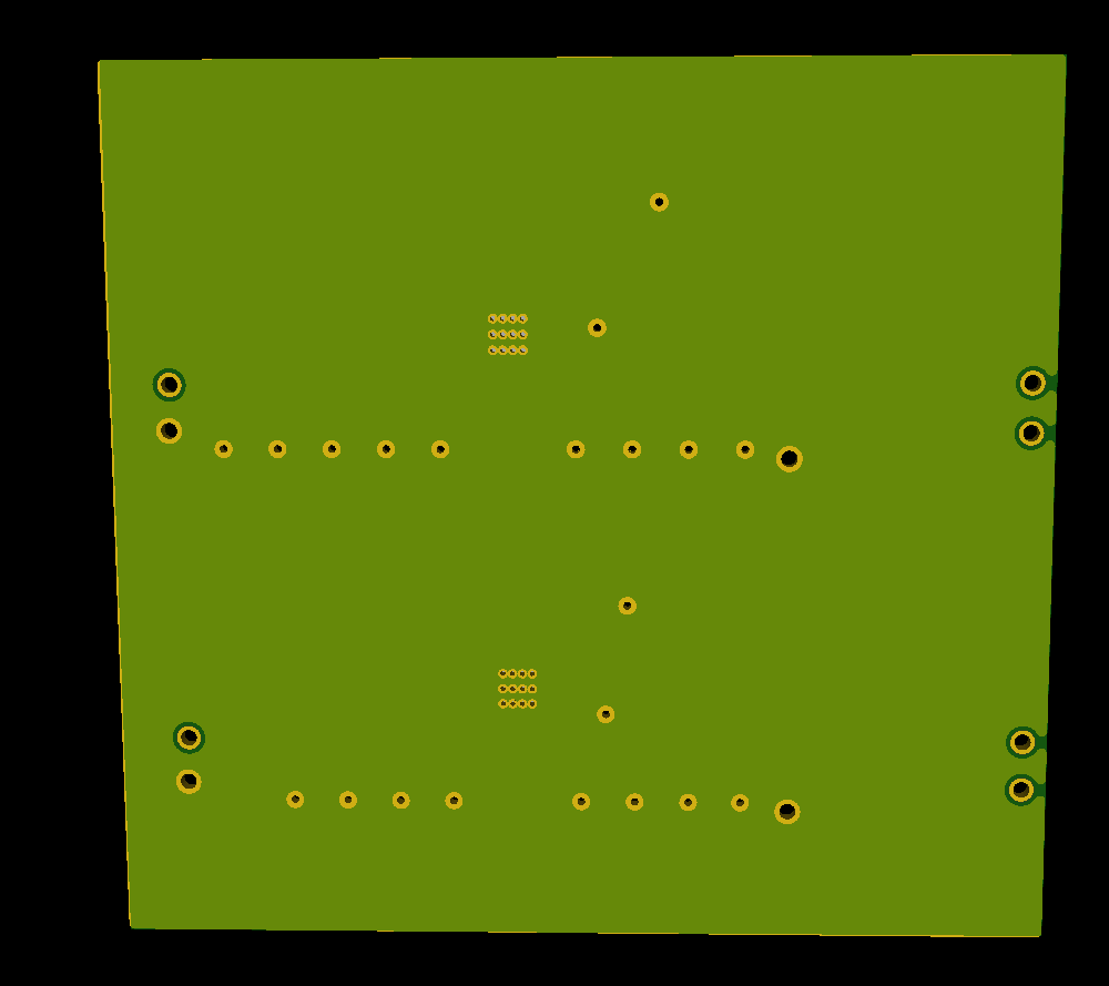

an adapter for PTH would never work well, it uses the copper for heatsink and feedback/sense would just be an absolute bitch, to get close to claimed performance, you would want the reference bypass and FB on the adapter part at which point you may as well do the whole PCB. no adapters but i'm doing a run prototypes shortly.
FB is not 100% laid out here in these snaps; i'll be running guarded traces to load point. the missing part at the input is a common mode choke, to form an LRC filter and the bank of resistors on the top reg (the 4700) is the Vout set/div using zero ohm resistors, as well as optional zener elevated 'ground' to hopefully allow running it at higher voltages (thus the prototype). the bottom reg is its negative counterpart, the 3301
the whole bipolar board is ~45 x 45mm

New widget from TI
http://www.ti.com/general/docs/lit/getliterature.tsp?genericPartNumber=tps7a4700&fileType=pdf
Would be nice to have an adapter board for TTH.
