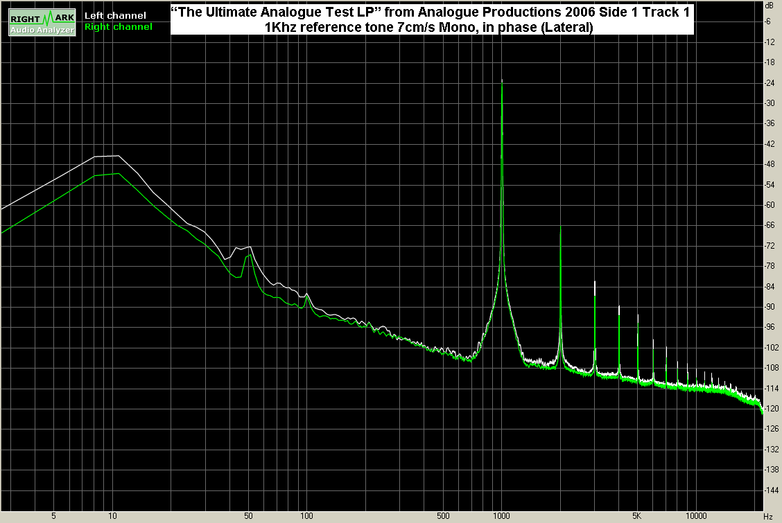

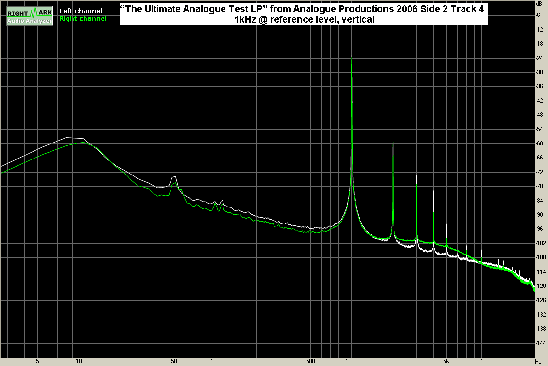

What you are pointing at? Vertical or transverse modulation?
http://www.diyaudio.com/forums/attachment.php?attachmentid=334646&stc=1&d=1362699535
http://www.diyaudio.com/forums/attachment.php?attachmentid=334647&stc=1&d=1362699535
Or is it distortion related to modulation amplitude?
See some measurements. Formulas in that link predict distortion products. Measurements show this.
http://www.diyaudio.com/forums/attachment.php?attachmentid=334648&stc=1&d=1362699535
http://www.diyaudio.com/forums/attachment.php?attachmentid=334649&stc=1&d=1362699535
http://www.diyaudio.com/forums/attachment.php?attachmentid=334650&stc=1&d=1362699535
http://www.diyaudio.com/forums/attachment.php?attachmentid=334651&stc=1&d=1362699535

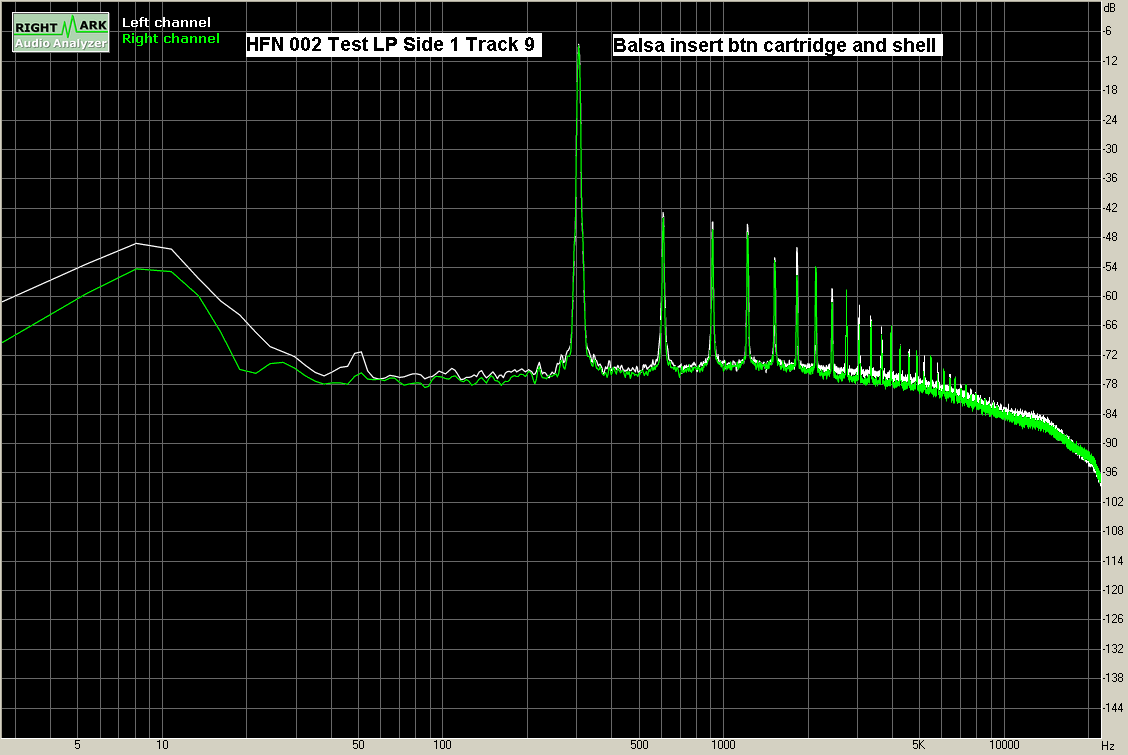

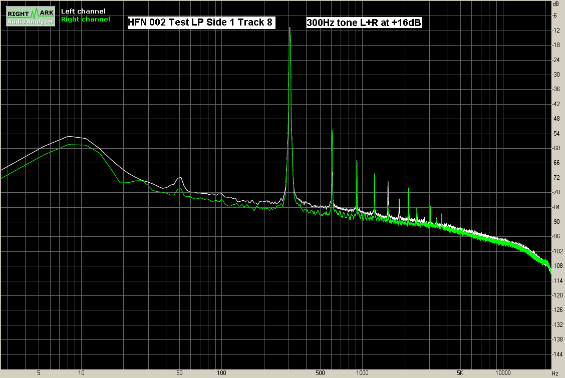

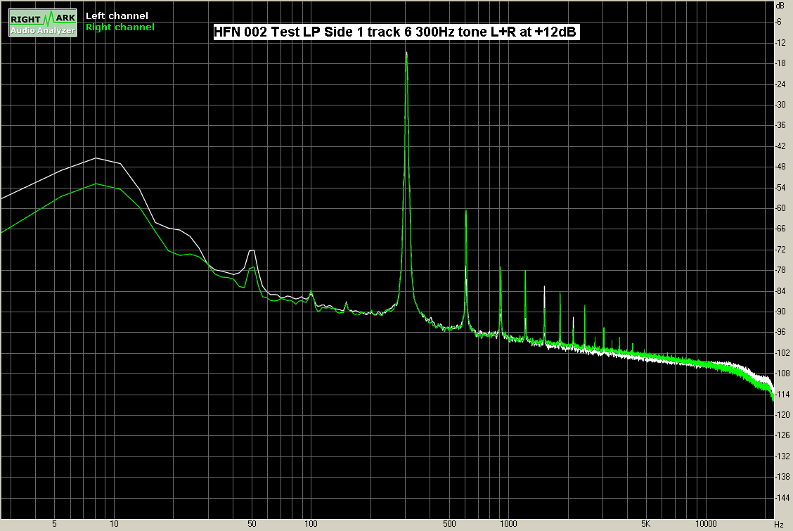

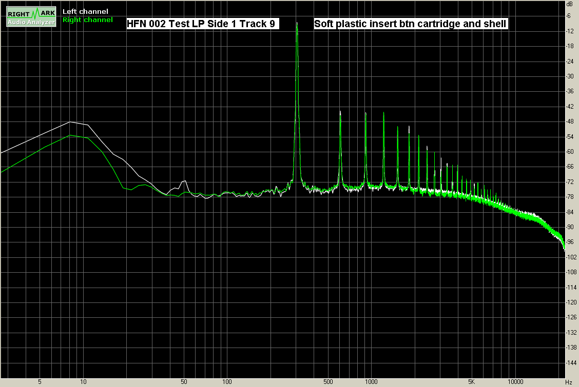

But there are a myriad “small” mechanical details that play a role too. See the following for some of them.
http://www.diyaudio.com/forums/attachment.php?attachmentid=334652&stc=1&d=1362699535
http://www.diyaudio.com/forums/attachment.php?attachmentid=334653&stc=1&d=1362699535
http://www.diyaudio.com/forums/attachment.php?attachmentid=334654&stc=1&d=1362699535
http://www.diyaudio.com/forums/attachment.php?attachmentid=334655&stc=1&d=1362699535
