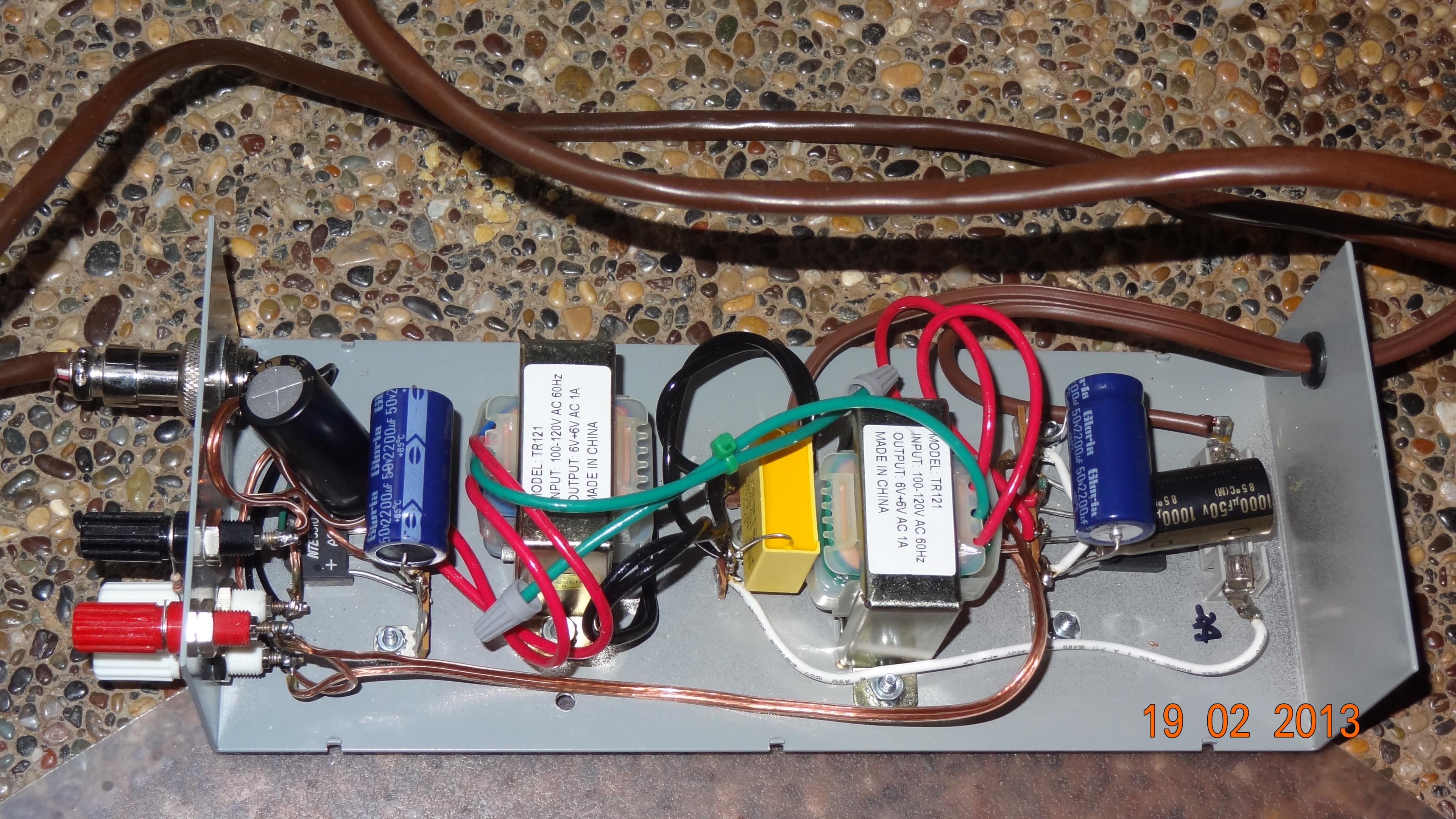

This is interesting stuff, thx. There is the brute force way: Use two transformers and rectifiers and filter caps to make seperate plus and Minus rails. What happens on one rail does not impact the other rail. Ground/common are seperate all the way to the V-reg common point. See attached.
But there are other ways less brutal, I'm sure.
Some things to point out --> Dont trust transfomer VA ratings as they are a competitive rating unless it is to a Standard and they state the standard for their regulation spec. In many cases a larger VA rating will help with regulation. Here I showed a 2A/2A windings and 4A core and only loaded it with 1.5A and the regulation wasnt so hot. Everyone needs to read the fine print on transformers.
Note also that most DC Volt Reg do Not do as well with incoming line-side changes as they do with output load changes. Pay at least as much attention to the Line Reg spec and impovements there will reap benifits as well.
Here I am looking for methods related to keeping the rails of equal value on both sides - line and load with asymetrical changes.
Thx for the interesting SIM data. -RNMarsh

RNMarsh,
I know I am not the one to answer your question you are asking here in a technical sense but I have seen designs where there was capacitive coupling between the two sets of windings before the regulators and also after the rectifiers. Is this something that you are speaking of?

RNMarsh,
Maybe -- Not sure. Can you attach any schematics/drawings of what was done as you describe?
Richard I will have to find the schematic. It was in the Gootee thread on capacitor size requirements for a power supply. It was an attempt to balance the separate winding in a center taped winding I think, but I may be incorrect and it was two separate windings without a center tap. So I will have to look and see what I can find of the circuit.
Go for it, I'm a big boy. 😀
