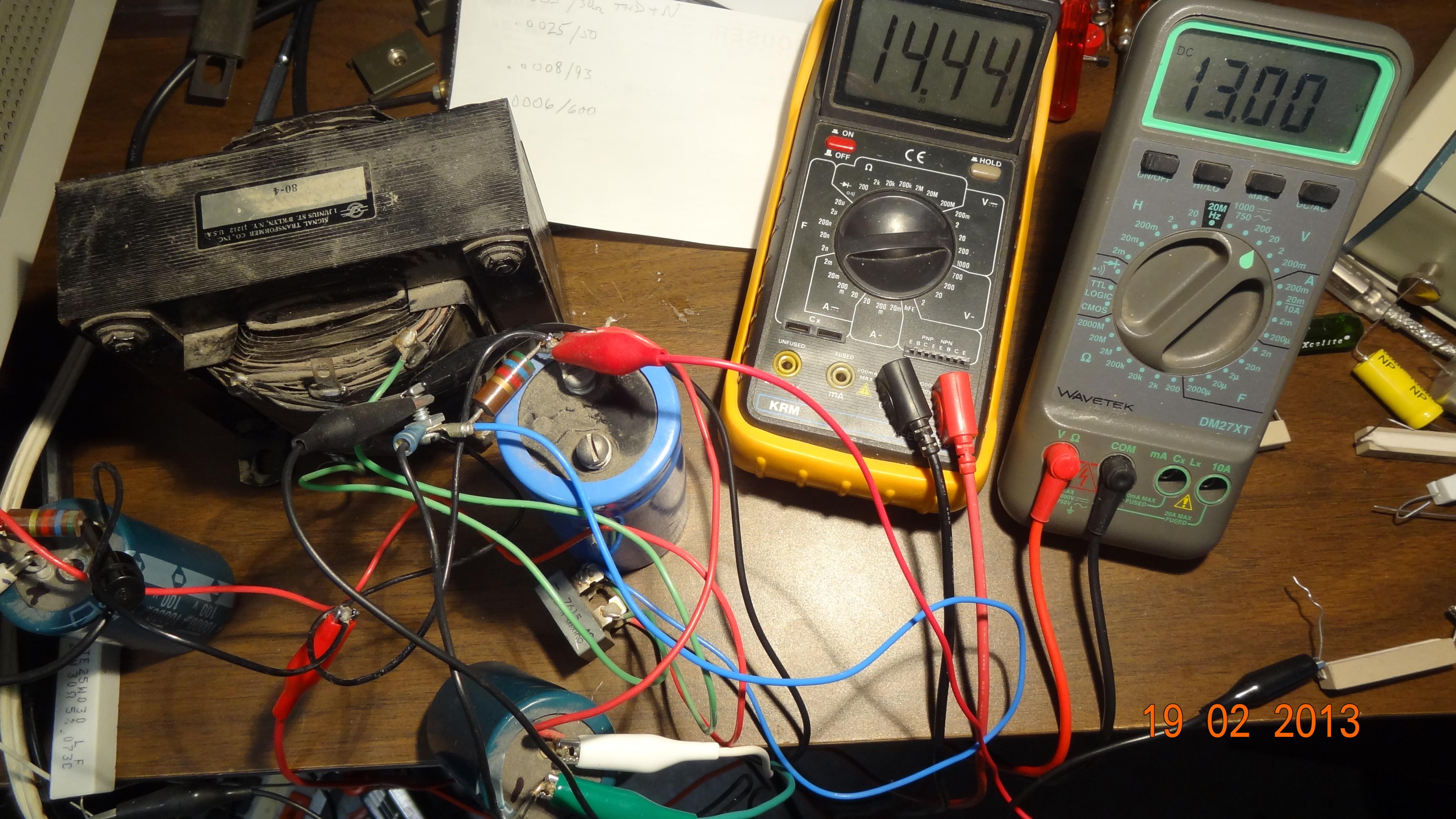

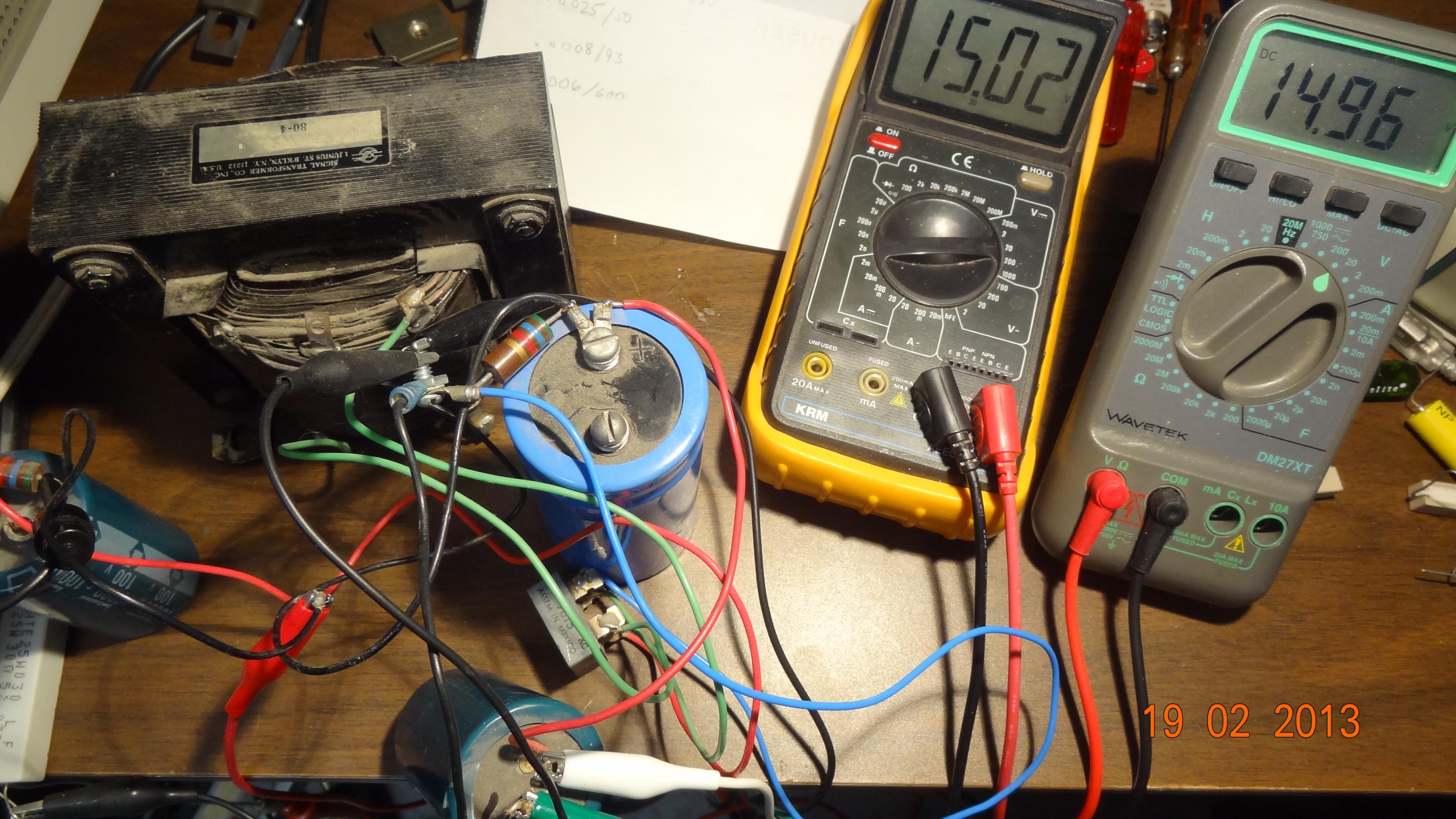

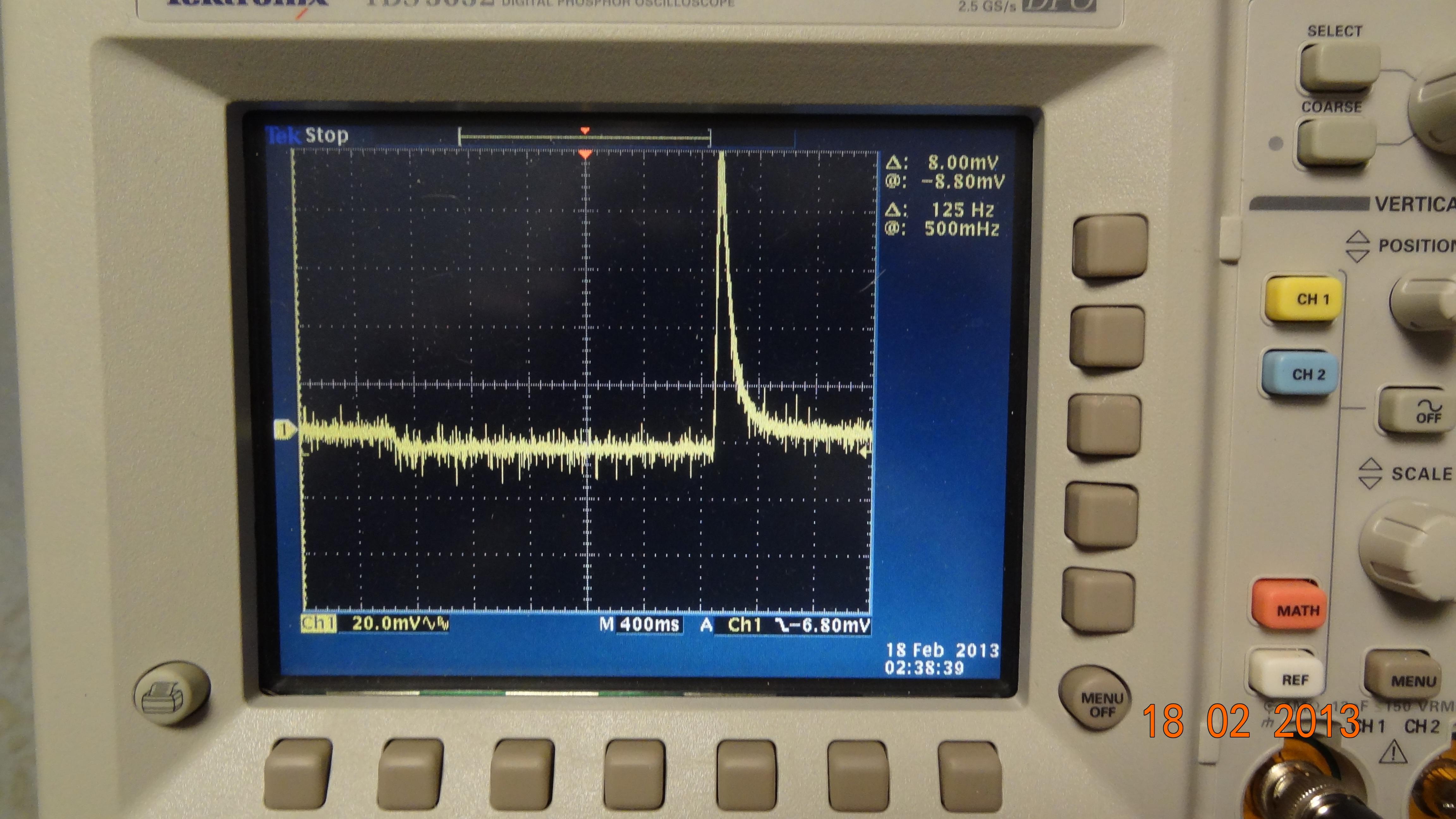

We have a 4A transformer used for a small power amp (Signal Transformer 80-4). A full wave rectifier and two 10,000mfd filter caps with just a 5.6K bleeder. On the left cap we monitor the voltage across it. On the right cap we place a 10 Ohm load momentarily (1.5A). The volt meter shows the affect of loading on the opposite side rail. And, on the scope we see that the dip from loading the Other side and then a spike when the load is removed.
Q: What caused the spike on the opposite rail and what will minimize it with the fewest parts.
Here's the deal: You tell me the correct cause and solution and win a free trip somewhere --

And what to do to minimize it at the supply level (not by increasing PSRR of amp) - all our (esp. power) amps with this type PS do this. So..... ?Collapsing magnetic field when load removed!
3 caps shown but only 2 are being used.One capacitor is disconnected?

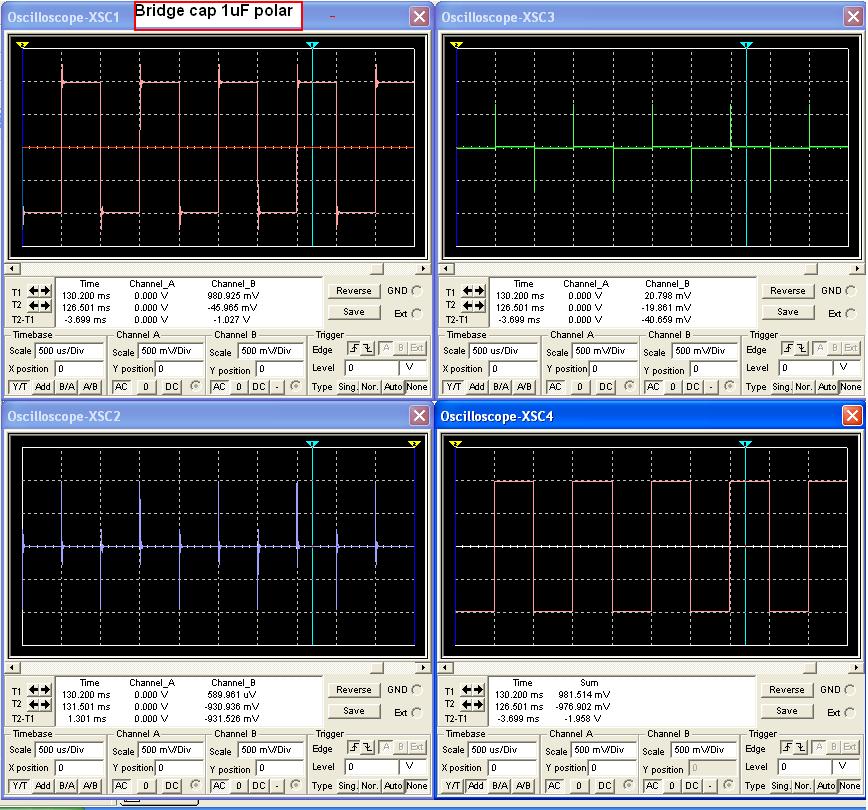

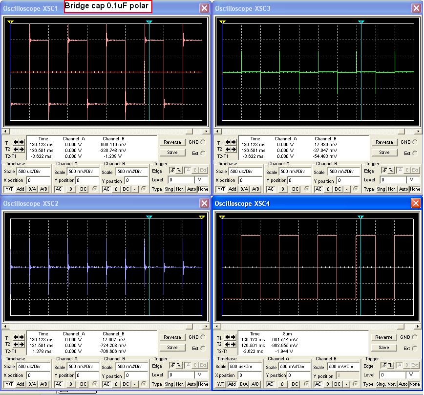

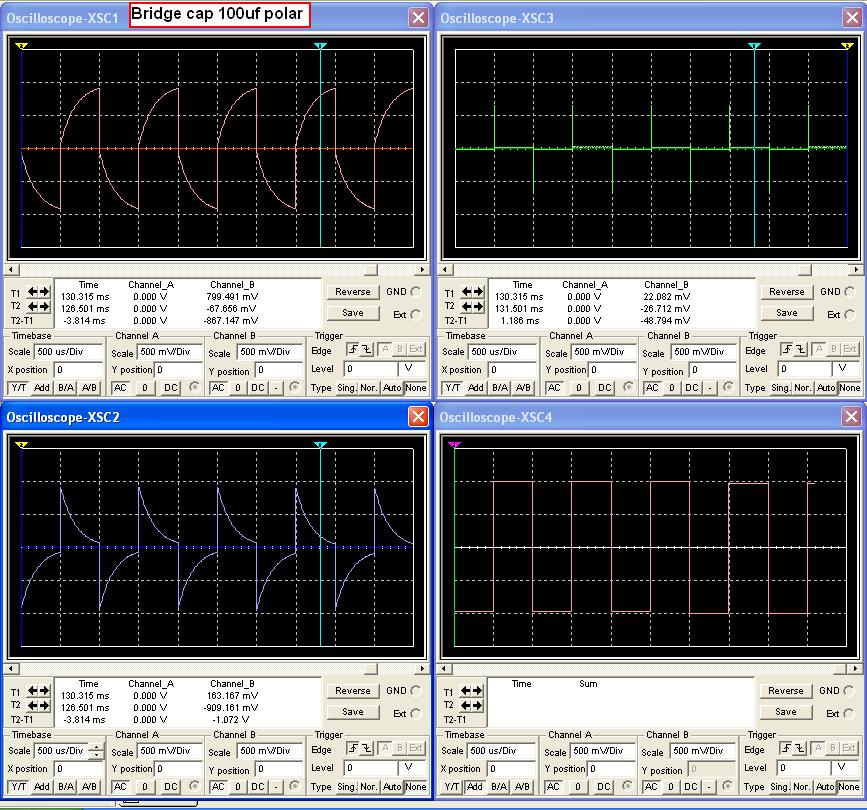

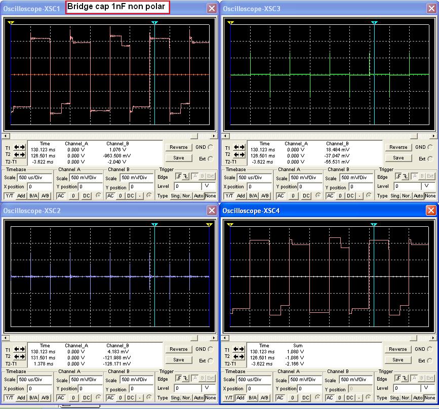

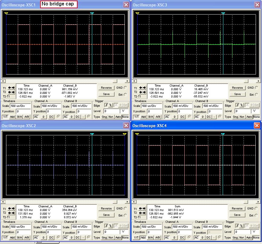

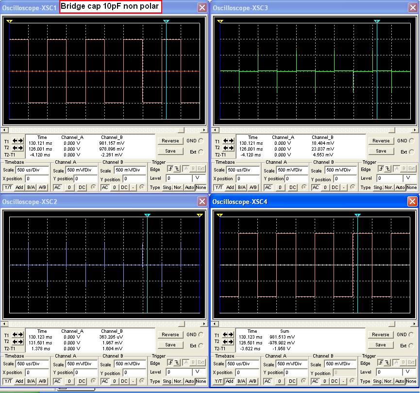

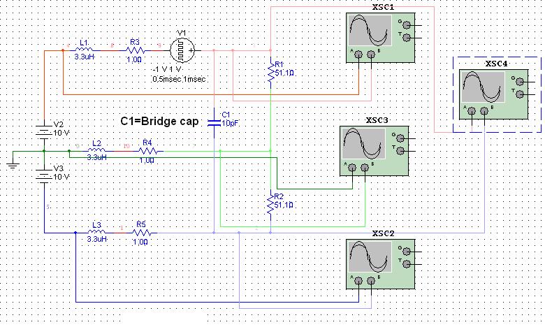

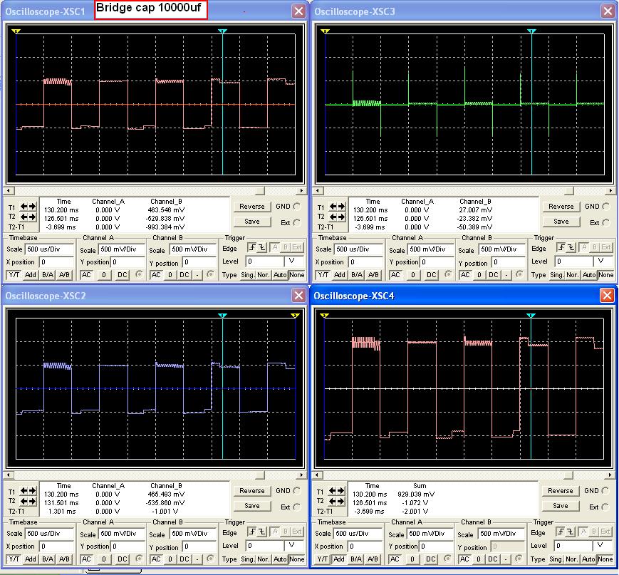

Richard I don’t participate in the contest because I don’t know the answer.
However scratching my head over the +/- rails bridging cap issue, yesterday I did some simulations (attached screenshots).
I am not into simulations and what I did may be naïve, but I was expecting for it to show changes on the center (0V) rail noise. (*)
It didn’t, and I don’t trust the results. When I have time I will do some real tests.
George
(*) When I first experimented with the bridging cap some years ago, I was monitoring the 0V rail current and I had seen the improvement there, alas I don’t find records from these tests.
