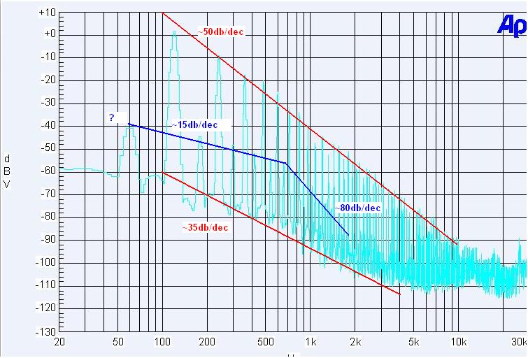

Now one more item attached. This is the spectrum of the ripple on a single capacitor power supply. How does this spectrum differ from the rolloff that would be expected from the single capacitor filter. (It has a single 470 uF filter capacitor.)
Here are your approx slopes
(What are the intermediate peaks (blue line)?
-40dB/dec vs. -20dB/dec
You are saying you have added 50 ohm load.
Pavel, do you imply that by increasing the load, the slope increases?
You two have me :scratch: (not to mention jn who has blocked me completely 😀 )
One :drink: and I'll think of this while counting sheep
George
