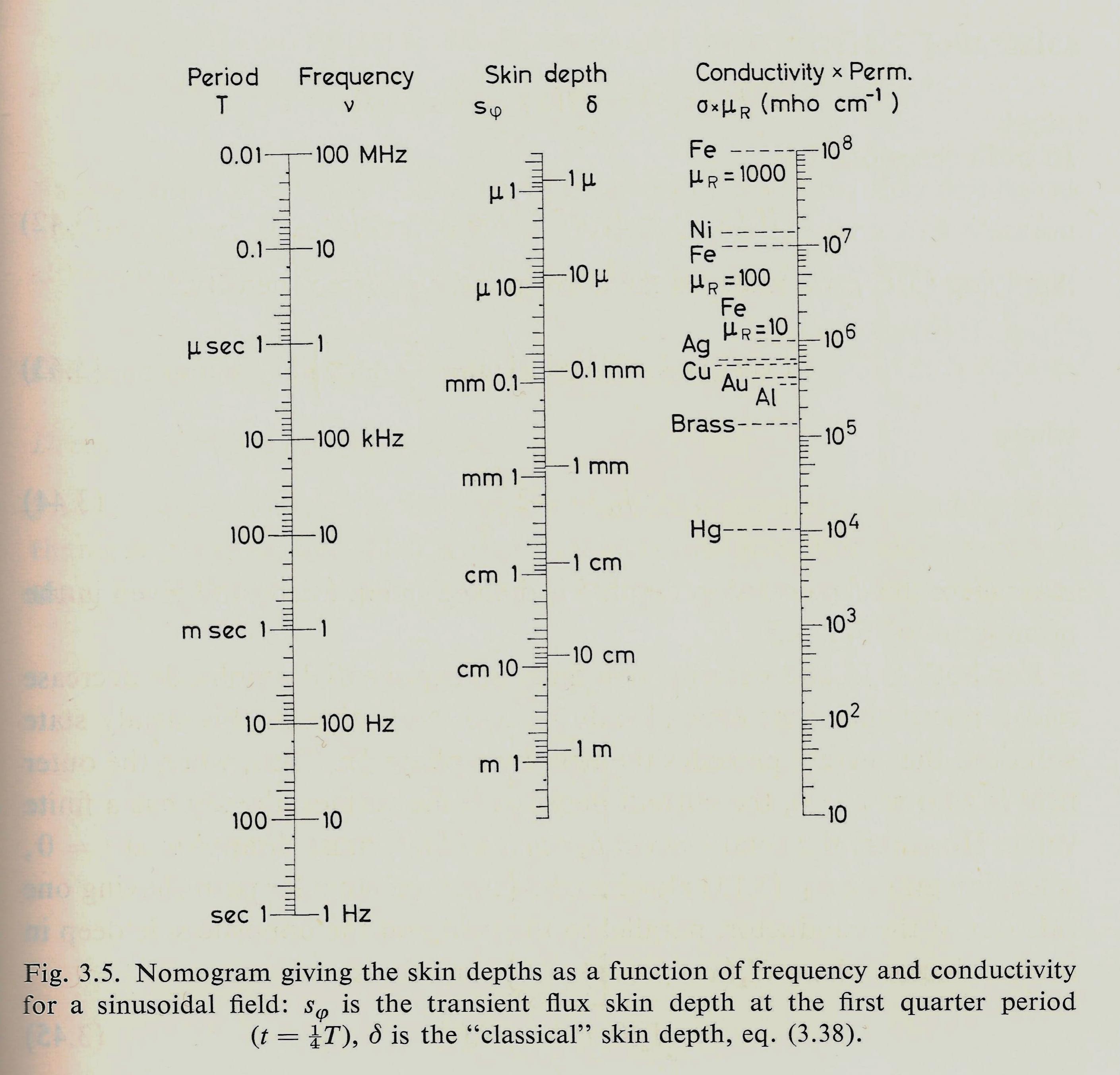

I didnt intend to show anything about the B field. I'll trust you on the proxy explaination. For others, attached is a nomogram for determining the skin effect (steady state and transient). Thx-RNMarsh
From Pulsed High Magnetic Fields by H.Knoepfel

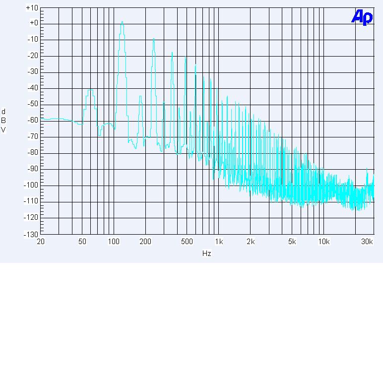

Now one more item attached. This is the spectrum of the ripple on a single capacitor power supply. How does this spectrum differ from the rolloff that would be expected from the single capacitor filter. (It has a single 470 uF filter capacitor.)
