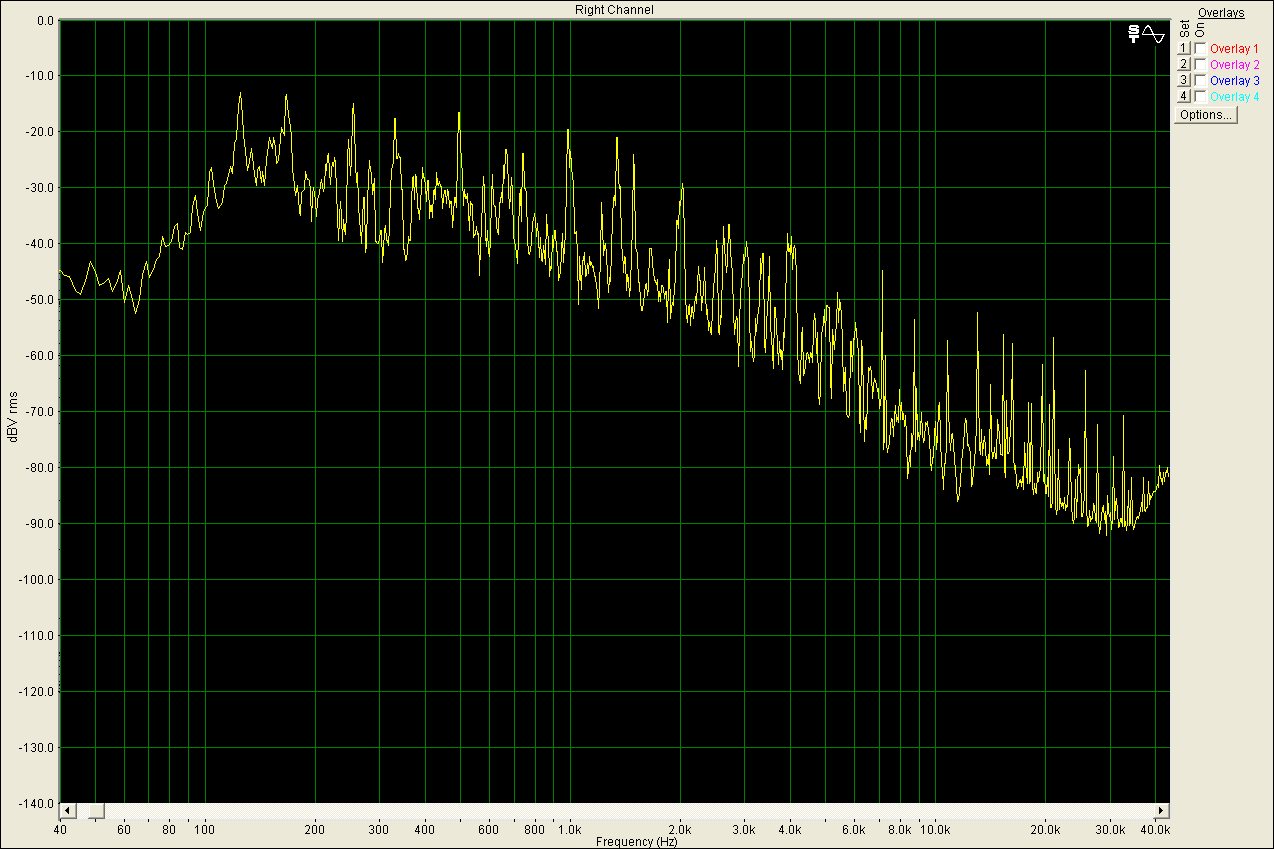

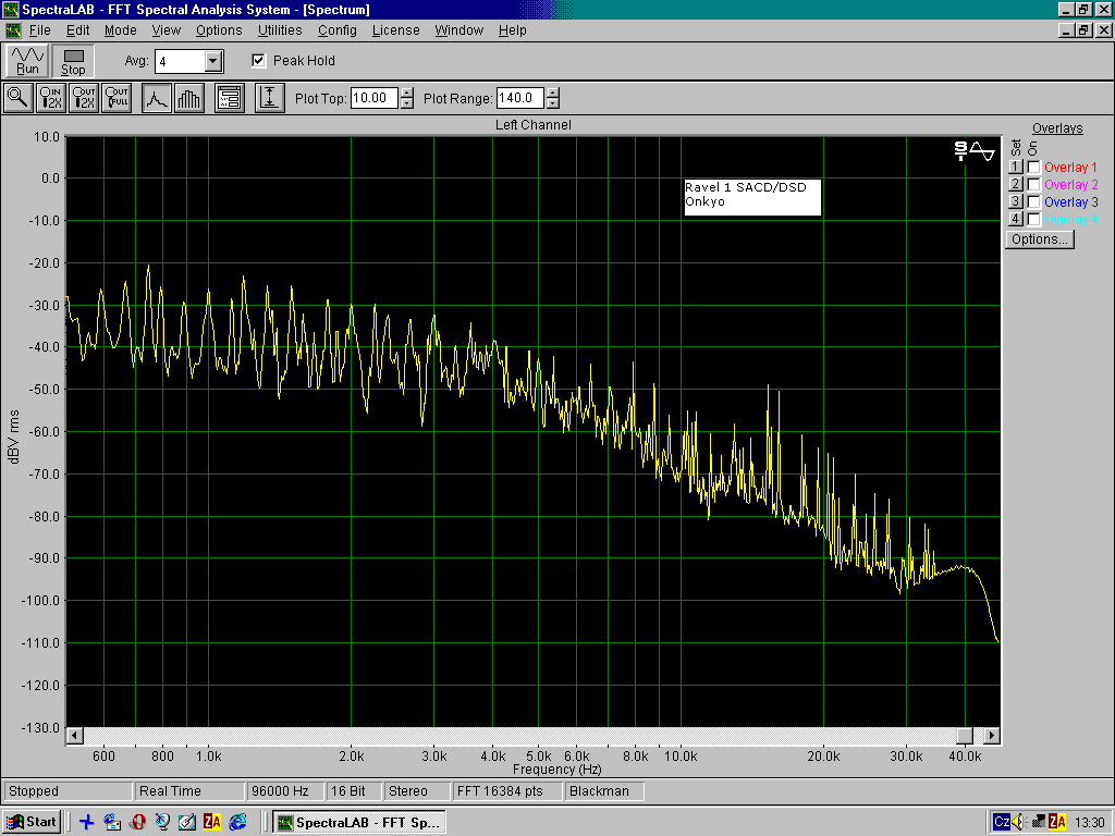

But to move towards when we can carry out such survey properly, anyone have a list of DSD recordings which are both musical and have significant supersonic energy?
Telarc SACD-60616
Telarc SACD-60601
Long live Renner and especially Bishop.
There are more titles, mostly Telarc.

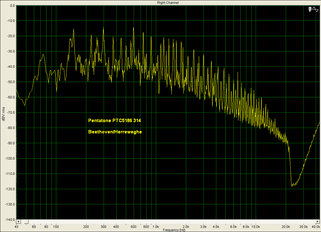

On contrary to previous:
That one looks rather like it started life as redbook - the bandlimiting to 22k is evident.
Sure. And you will find so many similar "DSD" recordings. TELARC was a real exception. I am not sure about situation now when Michael Bishop left and they probably are not that much involved in SACD.

Thanks for this Pavel.Telarc SACD-60616
Telarc SACD-60601
If you analyse any more, please post.
How do you do the analysis? Do you play them on a computer with a DAW? Please excuse my naive questions.
What is the time sample analysed? [edit] Oops! I see it is 16K @ 96kHz ie 167ms. Any reason why you chose this 167ms period? [/edit]

Richard, analog output of SACD players were digitized, mostly Marantz SA7001, but the 1st plot (Ravel) was Onkyo DV-SP503 universal player. USB sound cards behind analog output of players, sampling 96kHz/16bit and 96kHz/24bit (for these spectra it does not make much difference if 16bit or 24bit A/D). Some of the plots are quite old, like 6 years, and I do not have the exact setting (window length etc.) recorded.
Anyway, it is quite easy to sort recordings regarding spectral content above 22kHz.
