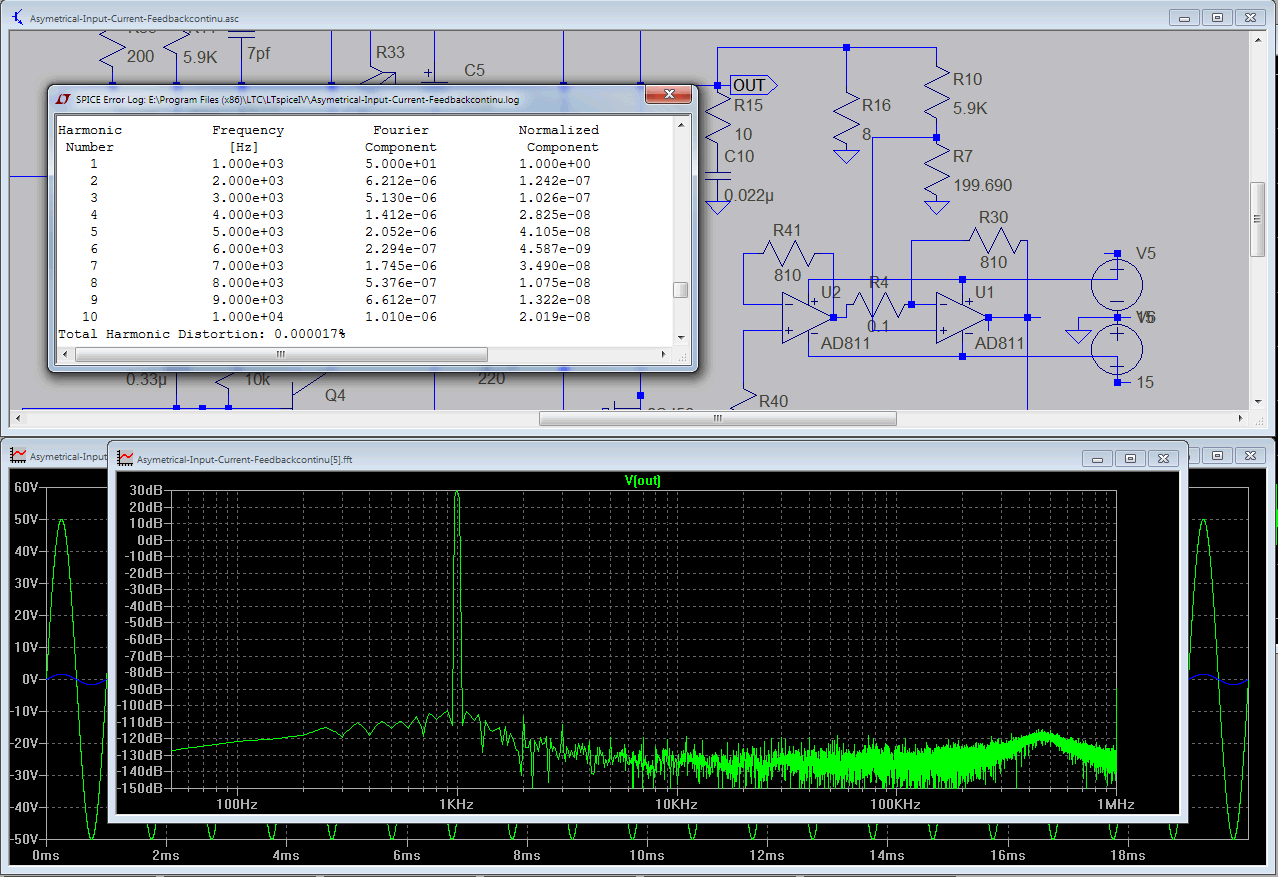

Applying the Bonsai error correction's idea, i made myself a gift. What do -you think of that ?
