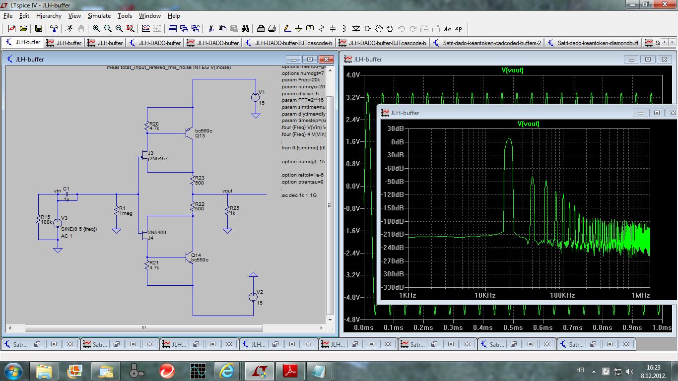

Oh those. They are the 2N5457 and 2N5460. Run at 1mA approx. Good for line levels. -RNM
John Linsley Hood buffer, maybe?
This is just simulation with diferent BJTs used, JLH used BC212/182.
dado
This is just simulation with different BJTs used, JLH used BC212/182.
dado
No. At my house it is called the RNM Buffer/Amp. circuit. 🙂 My own derivation is in Linear Audio #3. Its an outgrowth of my earlier designs that were published later in The Audio Ameature. That is when I first started talking to john Curl about it. In those early days, I used all bjt in complimentary push-pull circuits and only jFEt in differential (2N5564). have you seen them? Later, Borbely did the same topolgy in all jFETs and also published in TAA. You might do a sim of the amplifier version as used for a headphone driver. The one I made has been measured to be at or lower than .0005% THD+N. I have MicroCap 10 for sim work, Audio-Precison, HP339A and now a ShibaSoku AD725D to test audio circuits with. I never sim'ed it.... just designed and built it and listened to my headphones with it. Later, I measured it and then did some other work on headphone auto-EQ that I folded into the Linear Audio article on a nice little, cheap headphone amp. Thx-RNMarsh
