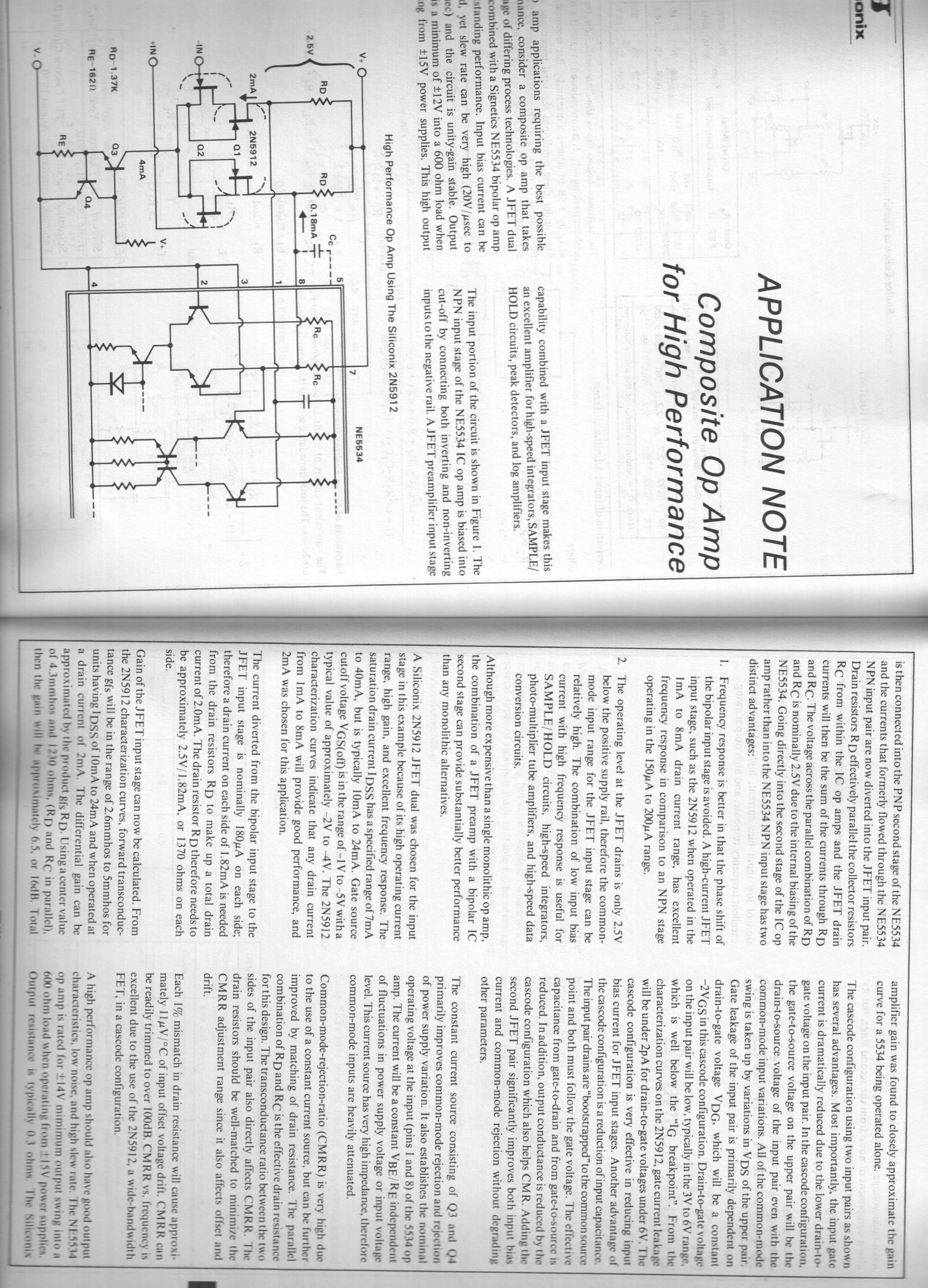

Thanks Esperado on your input of the Siliconix app note of the modification of the ne5534. They were trying to sell jfets, not IC's with that app. The real problem with that modification was that it was NOISY because the second stage in the IC was so noisy. It did eliminate thermal feedback to the input stage, however.

Why don't you ask Scott Wurcer to provide a schematic? I don't have one handy. He took the 5534 apart over 25 years ago, Raytheon wasn't it, Scott, that was considered the best? Siliconix supplied the idea for the op amp mod through the compensation pins, as I recall.
I think I lost it years ago. IIRC you pull the inputs to Vee to disable them and just put a JFET long tailed pair on the comp/offset pins.

This demonstrate one time again that the first stage of an amp is the most important, regarding the poles. I believe the slew-rate of this composite OPA was better ?App note: partial

Thanks for this JC. What complementary JFETs would you use these days?App note: partial. sil3.jpg
