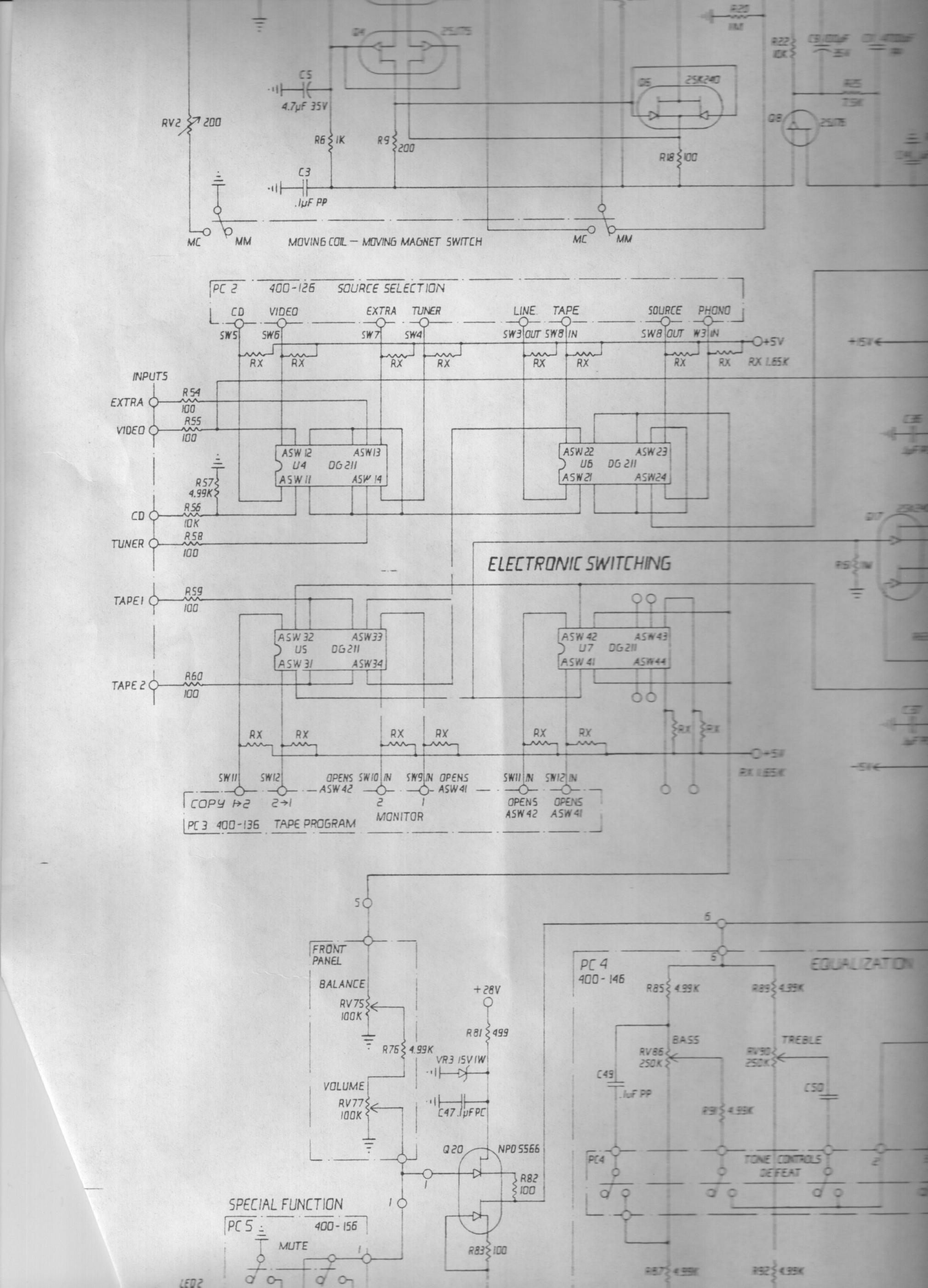

Esperado, have you no experience with mercury or solid state switches? I do, and I don't use them for my best designs.
I believe i have less than you. So, can-you share your ? I am less interested to know how much you are experienced than to learn from the content of this expertise.
You present yourself as a teacher, and, when we ask a technical question, your answer is near always "I know the answer".
My design with solid state switches in the Lineage preamp, 25 years ago. Since then, several other preamps with my circuitry use solid state switching. When we could, we went back to relays.

Esperado, do you demand that I try an ABX test to prove that gold on gold relays are better than solid state relays? Or do distortion tests matter? Or what?
Why such an aggressive and paranoid response ?
I asked-you why, it was sincere, i did not attack-you.
What is better on your experience ? Distortion ? Noise ? HF leakage when open state? What ?
What is the impedance of the following stage, when you feel something bad in static relays ?
Did-you try bridged, or parallel relays if you are in concern with the little non linear impedance ?
Long time behavior comparison ?
Why don't you like DIP ? Humid mercurial relays ?
Can't we talk technically, just for once ?
If i said, "i use OPAs" did it bring-you any information ? That is what you do.
On my side, i have tried to explain why, how, and in what context i use OPAs, and witch ones, so, if you are interested, you can try without loosing time and make your own opinion.

I need to know what you want. If you are happy with solid state switching, don't think that I am not surprised, but I want the best that can be done, and solid state switching just does not 'cut it' as that absolute best. In fact, relays are not perfect either. ONLY silver on silver self cleaning switches make the grade with me, so far. That is a PERSONAL OPINION, and I cannot show it in measurements. If I could, audio design would be so much simpler. '-)

For the others, if the reason of not using static relays is the *very little* distortion they induce, (May-be the reason why Mr. John "the great" Curl don't use them any more, who knows ?) why not try to cancel-it ?
Z is the impedance of the next input stage. Use the same Z in the feedback loop of this stage and add the same static relay in serial with it, always in "on" state.
Z is the impedance of the input stage. Use the same Z in the feedback loop and add the same static relay in serial with it, always in "on" state.
Because, the type of distortion they introduce is extremely non-linear; it may be low level, but it's highly obnoxious in its effects -- it's just not cancellable.
