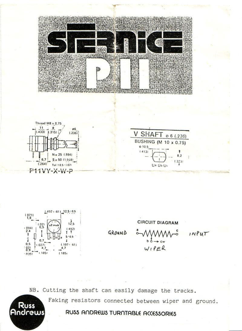

Are we talking about a small white double linear one with short shaft and terrible L/R balance at start of rotation? It would not give any signal on one channel at medium whisper level actually! After kicking off was OK for balance though. I used that little thing back in the early 90s, law faked with Vishay's lowest PPM resistors of the time. I got it from a guy named Russ Andrews from Cumbria UK. Was a TT tweaking guy. I don't seem to can find it easily so to take a pic, I am not sure I still got it even, maybe it finally gave up the ghost, but I found its paper from Russ! If it is the same, yes I remember it as the most transparent pot I ever got in my system back then. The bad functionality broke my nerves in the end. After both channels would kick in (grrr!) then it would climb up fast even with 20:1 law fake. I remember that when I substituted it with Alps blue, and then Bourns blue, I could finally control my volume but they were thick as mud in comparison. Irony, and was costly too.😀
