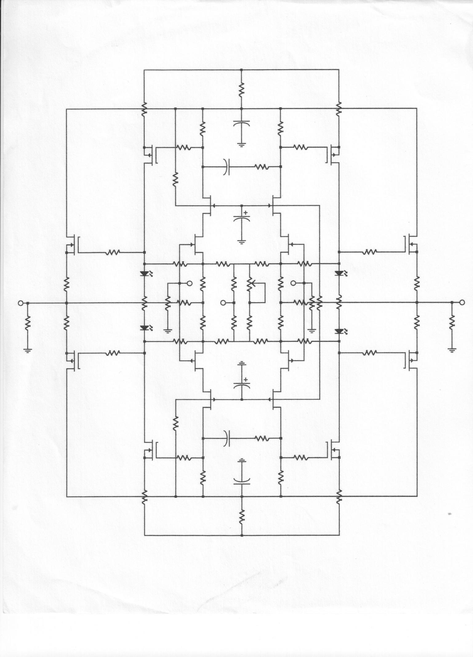

I have. It seemed fine.
The schematic isn't that mysterious and can be pieced together from knowing the topologies that John generally uses,
What is intellectually interesting to me is why THAT topology and not the many others available then and since? That's where the learning for me is of interest. Not blindly copying it and/or a sim of it for DIY build. Its in that distillation of many issues into a compact circuit that best meets the goals. Knowing the right goals has to be known to get the design distilled.
Also the pcb has advanced ground routing/guide paths and the like which is not blindly done, either. That is nearly a lot art. -RNM
