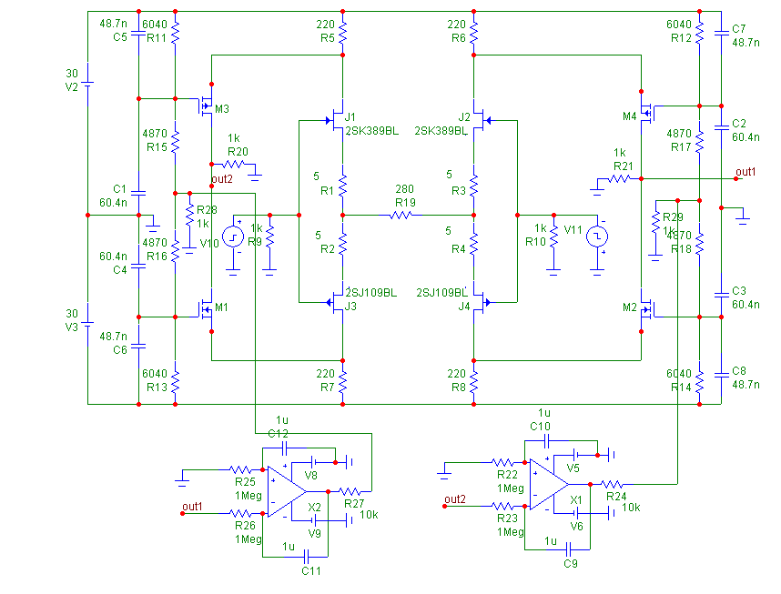

John, what would you think about the added capacitors (parallel to dividers), pl see image.

Hi PMA
A thought;
Since C-6,5,4,1 etc are in series for noise common to both supplies, and individually on each so they form a capacitive Voltage divider also but with somewhat different ratio than the resistors. (Oscilloscope probes often use a Capacitive divider, two different capacitance's instead of two resistors).
If your inclined (or perhaps sitting in your chair haha), try removing C-6 and 5 (7, 8) and place them from ground to the supplies (ala bypass caps in digital, close, place them close to the R15,16 and c1,4 junction..
This leaves the gates referenced to ground (where the output is referenced) and the divider is now a low pass filter to that reference.
Best,
Tom
