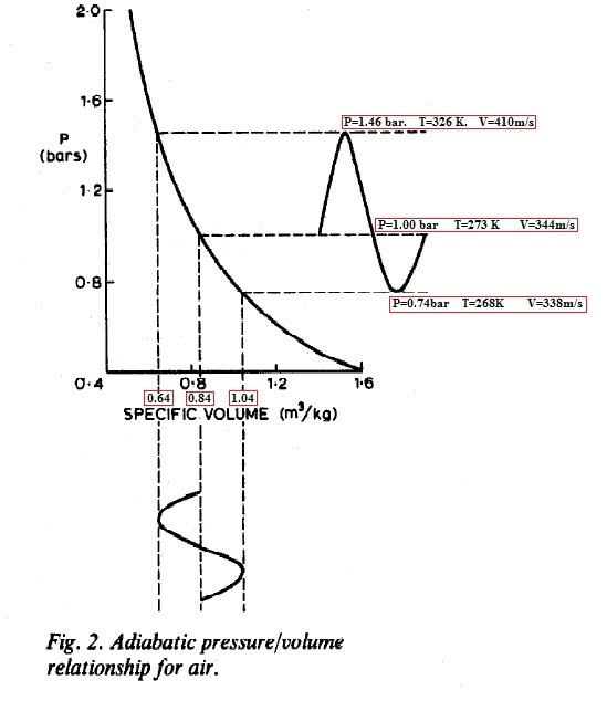

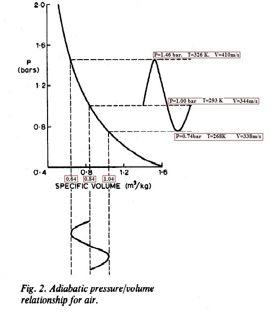

Air behaves quite close to an ideal gas for practical audio cases.Compressibility factor Z is a measure of how much a gas is close to an ideal gas (Z=1).
For compressibility of air, see bottom of this page:
Compressibility factor - Wikipedia, the free encyclopedia
Zair=0.9957 to 1.0020 over a range of 1-5 bar and 250-500d Kelvin
I did some calculations for to plug some numbers (in red boxes) on the waveform from the article of Dinsdale.
Looking at this waveform, how much do you think is the % 2nd harmonic distortion? Is it somewhere btn. 20% and 30% ?
This “air overload” mechanism of distortion will be stronger for higher frequencies. With lower frequencies, there is more time for heat diffusion, so the curve will be less steep, tending more toward an isotherm. The distortion will be considerably less.
The temperature difference due to adiabatic compression – expansion btn. top and bottom of the waveform changes the sound velocity locally. For the numbers there, the difference is 72m/s. This will skew the waveshape clockwise, adding higher orders of distortion.
How much is the sound pressure level of this waveform in db? 90 or 180?
