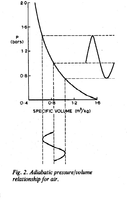

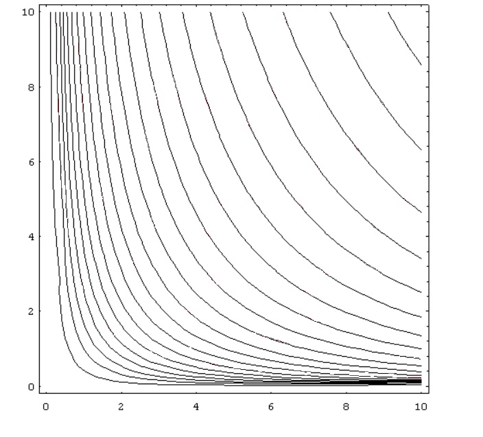

What can not be modelled I guess (and thus corrected by pre distortion) in a horn is the mess that happens in the compression chamber (the volume between the driver diaphragm and the throat aperture of the horn), especially when there is no phase plug. “Near field” amplitude/phase variations, internal cross reflections, diffraction effects, volume resonances., high pressure chaos.
Jneutron, the process is adiabatic. Front of the wave, hot. Back of the wave, cool. As you say, heat travels with the wave. See left attachment for wave distortion that Mr. Danley is speaking of. On the right, Pick your curve and draw the distorted wave.

Ah, wait...the assumption is ideal gas law. With high spl and energy density, that isn't accurate. I pointed out that concern a coupla posts ago. The equation P1V1/T1 = P2V2/T2 no longer holds. All you can do is drop back to the relation P1/T1 = P2/T2 (Gay-Lussac's). Volume is not constant through the pressure wave, nor is temp. (The pv/t=pv/t equation is not deterministic by virtue of the model..as the wave passes, we are not talking about the same quantity of gas, the equation only holds for a specific quantity of molecules. Gay-Lussac's avoids that constraint.Jneutron, the process is adiabatic. Front of the wave, hot. Back of the wave, cool. As you say, heat travels with the wave.
As with all physical processes the temperature of the gas will lag the instantaneous pressure..heat capacity. That difference merely modifies the wave profile a bit over a zero heat capacity model, but the same basic effect as Tom mentions.

ah, 3rd and 4th link, mention adiabatic. That is only true for an ideal gas with spl's not excessive.
As I recall, Abraham B Cohen (sp) discussed the adiabatic distortion of the throat, and I think he used the back compression chamber to balance that out. He never really formed many equations, but did seem to know what he was doing..Wasn't he a violin player?
