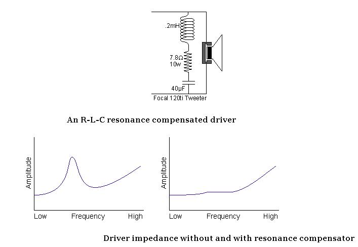

It change the Thiele and Small parameters(speakers+motional compensation QTS.)
Christophe, are you talking about something like this?
the Fs and air volume remain the same, so , believe the vents will resonate at the same frequency ?
I have always used-it with a well tuned enclosure ( equal impedance peaks around fr )so i don't know how it turn when it is not. I believe the resulting impedance curve will not be as flat.
If you change the TSP parameters (although I cannot see how this would be
the case) the alignment changes (There is more to it than just fs and air volume).
Additionally "equal impedance peaks around fr" by no means do assure a maximally
flat alignment.
I really would like to see some measurements with and without this impendance eq (same enclosure, same driver).
Of course, if you alter the impedance curve by some network and then measure the
TSPs the usual way (deriving them from the impedance curve) by using a current (or
reasonably large resistor) you just have messed up your TSP measurement.
These "new" TSPs have no relationship to the drivers TSP when driven from a low impedance
source (amplifier).
source (amplifier).
You got-it !Christophe, are you talking about something like this?

Let-us be clear.Of course, if you alter the impedance curve by some network and then measure....
I am unable to modeling-it. I'm not a theoretician in electro-acoustic.
I agree that, if you flatten the motional impedance of a loudspeaker at free air, when it is charged by a bass reflex, the resonance frequency had changed, so this network will not be at the good frequency, so you will expect some up and down in the impedance curve.
But, as astonishing it can be, it is not as-it.
It works. Try-it by yourself, please, as i have done-it hundred times... or forget.
Of course, it will be more precise to measure your speaker in your vented box, then provide two networks for each peak around the resonance. You double the work as well as the price of the expensive inductances and caps.
No need, as, believe-me, please, it works all the time by the way i indicate.
I will try to provide-you some real curves, please be patient.
