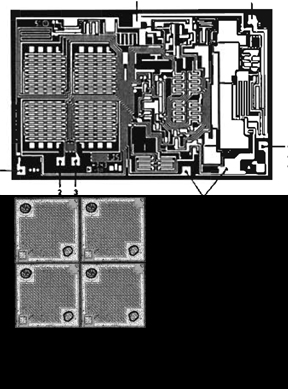

No, sorry to disappoint all sim only no audio listening. This part was done for spy sonar and CAT scanners.
Here is an interesting picture comparing it to 4 2SK170's.
