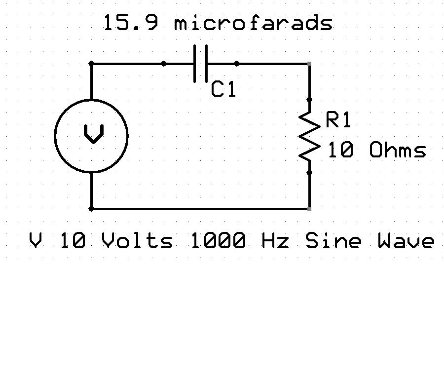

Before I go further let's see if we can get agreement on a really simple circuit.
Pavel, Wavey, Scott, SY and anyone else interested, would you each please post an answer to what is the power dissipated in the resistor in the attached circuit?
5W.

Over half period of sine. Over one complete period it is zero as Ed has stated.
No. 5W for 1kHz/10Vrms sine, 15.9uF capacitor and 10 ohm resistor. Please check the Ed's image, it is really a trivial task.
PMA is a winner.
Impedance modulus of the cap is 10 Ohms at 1kHz, but its vector direction is 90 deg down from 10 Ohms of the resistor active impedance. Total impedance modulus of the RC chain is SQRT(10**2 + 10**2)
From this we calculate current and power dissipated on R.

The reason why it is not just Xc/(R+Xc) is the phase shift when R = C is 45 degrees. I do want to go over vector math in a bit.

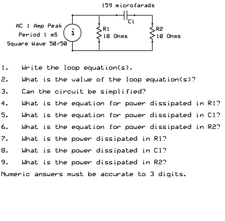

Back to the problem.

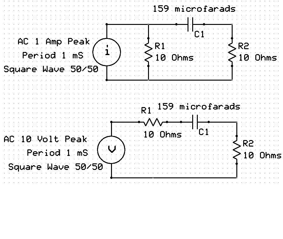

Pavel showed a nice simulation and answer that the power dissipation is the same in both resistors. Now for some that doesn't seem reasonable as one is in series with a capacitor and the other is directly across the power source.
So lets look at what happens. As the current starts from zero and rises to one amp the capacitor charges and the voltage across the capacitor rises. This drops the voltage across R2 but since we have a current source the voltage rises across R1.
When the current source goes from 1 amp to -1 amp there is still a charge on the capacitor and this must discharge through R2 so the initial surge current is a bit greater than from just the current source. As the capacitor charges in the other direction we again see more energy into R1.
Now the next issue was can the circuit be simplified? The answer is to treat the current source and R1 as a Thevenin equivalent.
The attached image shows what happens.
For those who don't understand the transform, compare the open circuit voltage and the short circuit current, they remain the same. So the two circuits are equivalents and make it clear that the power in R1 must equal that of R2.
Now that we have discussed power in an RC circuit and reduced the problem to one, What happens if we calculate the power in R2 by using a Fourier series to represent the square wave voltage source?

I actually expected someone to give the answer of 10 watts as capacitors do not dissipate power. But most of the PM'd answers were 2.5 watts! (And I will not admit to having made the same mistake myself once or twice!)

I found it vague and pointless. Your most recent "problem" even more so: "Solve this using an inappropriate tool."
SY,
The use of loop equations is the first step in analyzing any circuit. Although on a very simple circuit many can isolate the issue and use an easier method of solution, but then when confronted with a large complex circuit having the skills to dissect it and solve it are needed.
Now today most folks will use a simulation program that figures out the loops and does the calculations automatically.
But I think most of us even here recognize understanding how the simulation works even if we could not do the entire job by ourselves is a great benefit.
Now the questions were dead bang simple and what you get out of the answers is for some a refresher, for others a new experience and for some it casts new light on old problems.
You certainly don't have to pay any attention to it. However as you chide John for not doing double blind tests, I reserve the right to chide you for not even attempting the simplest question.
I picked that one because I figured almost every one knows that when the reactance equals the resistance that is the half power point.
