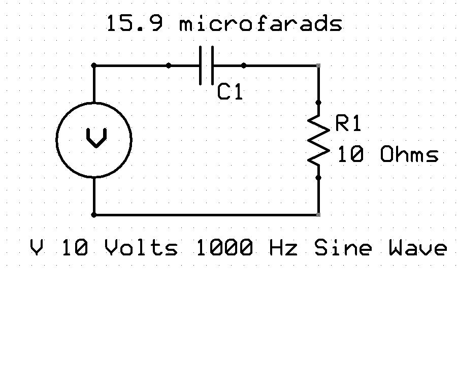

Before I go further let's see if we can get agreement on a really simple circuit.
Pavel, Wavey, Scott, SY and anyone else interested, would you each please post an answer to what is the power dissipated in the resistor in the attached circuit?
