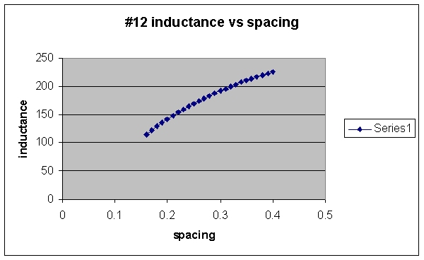

Sigh..About 150 micro Henry for 2 wires, 20 meters. How long wires does Billy Gates have?
You sure, Wave? Rule of thumb, 7nH per cm of conductor in free space, I make it 15uH for that scenario ...
Frank
Sigh..
Let's check.
For 20M of 2mm thick copper wire it is 39386.7389298843 nH
2 wires in a cable will give approximately 4 times more. 140 micro Henry.
My rule of dumb gives closer result.
Did I miss anything?
Here is online calculator: Inductance of a Straight Wire: A Calculator
Sigh..
Yah, but we have plenty of choices...Boy! This is great. We have 15uH, 50uH, 140uH and 150uH. Good thing you all dont do design work for a living.
Join the company. What will be the number if to design for living?
Here ya go..this is the result of applying the Terman equation to a 12 guage wire.
A single wire inductance can only be calculated as the internal inductance of the conductor, which is 15 nH per foot. The external inductance of any wire has to include the return path of the current. Without knowing the return path, one cannot calculate total inductance.
John
BTW, the vertical scale is in NANOHENRIES PER FOOT of conductor pair.. #12 romex is probably about .4 inch spacing.
