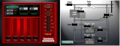

.... I had made a power amp and was in such a hurry to try it that I forgot to set the bias (was set to min). I heard it and got excited! So, this is what some high end reviewers were talking about -- debt of sound stage all over the place. Spacious sound with all the fundementals there. Then I went to check/set the bias.... and measured the thd... it was higher than i expected it and wanted it to be. I set it to my 'normal' and relistened. That great wide, deep and spacious sound stage was gone. It was a let down. High distortion gives this and enhanced these sonic affects that arent in the original recording. Some tube amps and SET amps which are often high (-40-ish) levels seems to me to be not accurate sounding but it is loved by many. Why? Becuase it more accuarately reminds them of music halls they have heard music played in (?). Thx -RNM
That's an interesting observation, Richard. One can probably get similar results by using this tool.
How many here realize that this one gets used (and abused) quite a lot these days during mixing and at the final stage?
