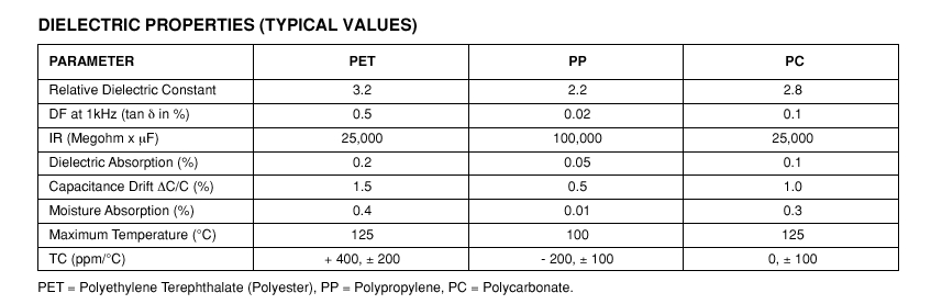

Has anyone here ever checked whether the "other" effects scale with DF (tan /\) instead of DA?
I always liked this parameter (DF) better when judging capacitor performance from the data sheets, to be honest.
