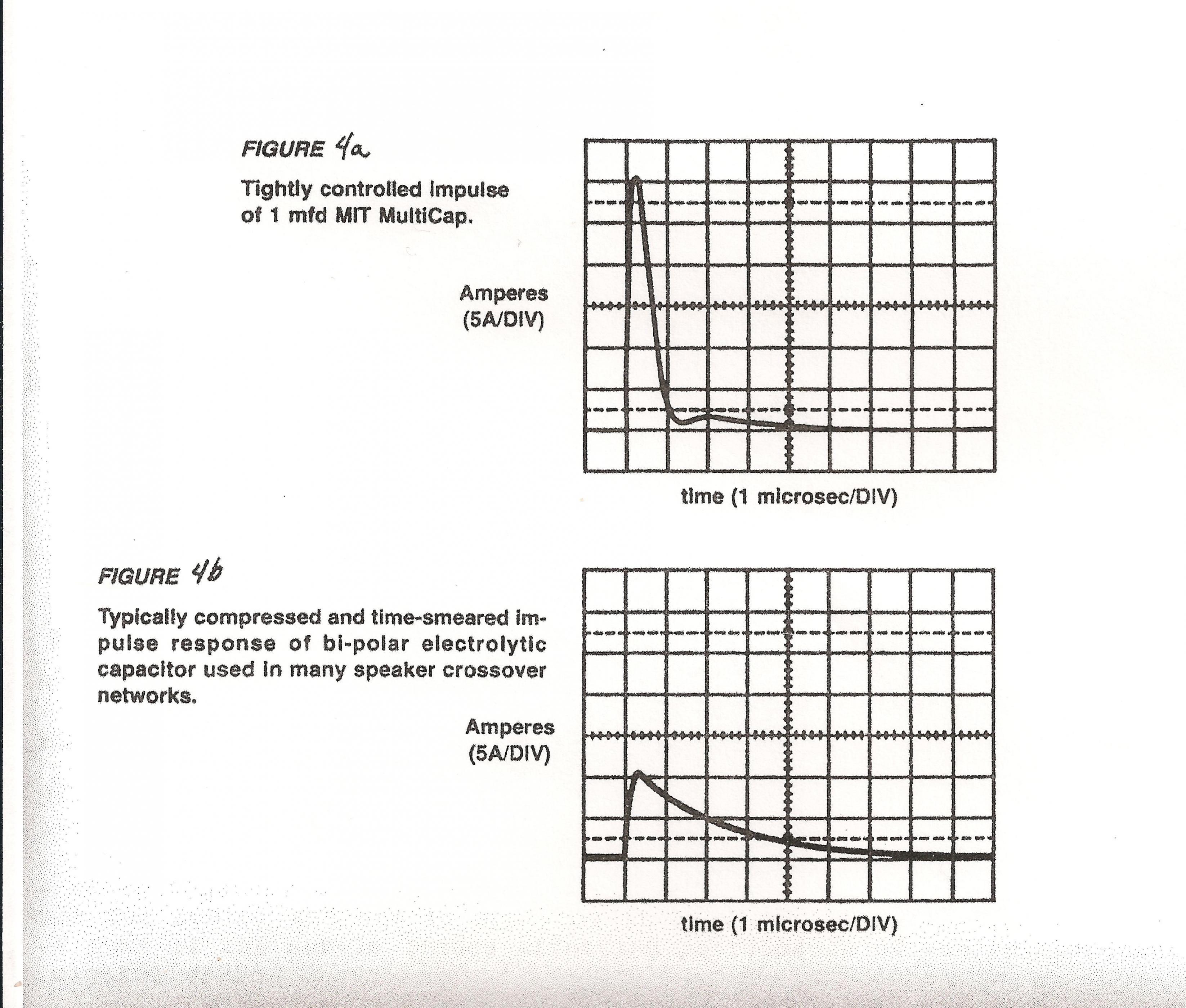

Another view of how things sound and a test measurement that correlates: The peak current thru two caps of same voltage applied and same value. One film and foil and one the popular bipolar cap --- listening says the bipolar makes the sound compressed in comparison. This is yet another view of cap behavior
- especially useful info if making speaker crossovers. -RNM

Time smear on a 1us time scale, you have to do better than that. Please submit these results to an unbiased listening test, no measure and send to audio buddies. I have seen no controlled by any standards test to support these conclusions.

This was discussed in more detail at DSPx in 1995. You dont have to believe it or even do a listening test - already done years ago. Its the effect of esr of the bipolar & film that is being shown. The effect is greater with larger cap values, of course......and heating due to repeated high currents transients only makes the esr worse. With bipolar caps the dielectric is significant part of the esr as well. I am sure you can extrapolate the time scale yourself with a typical (100+ mfd) cap used in speaker crossovers. Larger values (than this example using 1mfd) like those used in speaker crossovers would be subject to possible esr modulation as well...and thus phase modulation of the filter slope....though I didnt measure or hear from others a sound description that indicates it is audible or significant that way. Live and learn. I put it here for all now and in the future to do their own eval. its another test current impulse test (non sine wave) besides THD on caps. -RNM
. You dont have to believe it or even do a listening test - already done years ago. -RNM
References please, maybe I missed them. Personally I don't think this sound of capacitors stuff holds up under careful scrutiny. Private club tests where "it was obvious to everyone in the room" don't cut it. If these effects are not at least subtle, you understand my suspicion.
