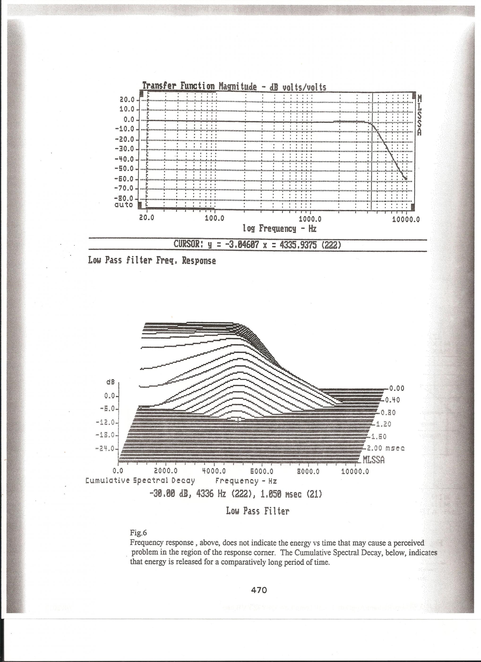

How linear distortion sounds non-linear 1
The attachment for low pass filter and it's time delay waterfall:
The sound in the region of cutoff is a source of distortion in the sense that it isnt clear and smears or obcures other signal details in the region. In addition, some will hear this area of extra energy level and describe it as being peaked near this region. -RNM

According to the graph it is peaked! Maybe 1-2dB? The Q is a bit too high.RNMarsh said:In addition, some will hear this area of extra energy level and describe it as being peaked near this region.
Ringing of high order filters is heard well, even if on frequency response curves they have no peaks.

If you want no ringing you probably need a linear phase filter. Note that ringing does not necessarily mean the filter is adding anything, as ringing can occur by subtraction. Nothing to do with distortion, anyway. Our ears are quite good at hearing one issue and blaming something else. No reason why our brains should follow.
[snip] Our ears are quite good at hearing one issue and blaming something else. No reason why our brains should follow.
