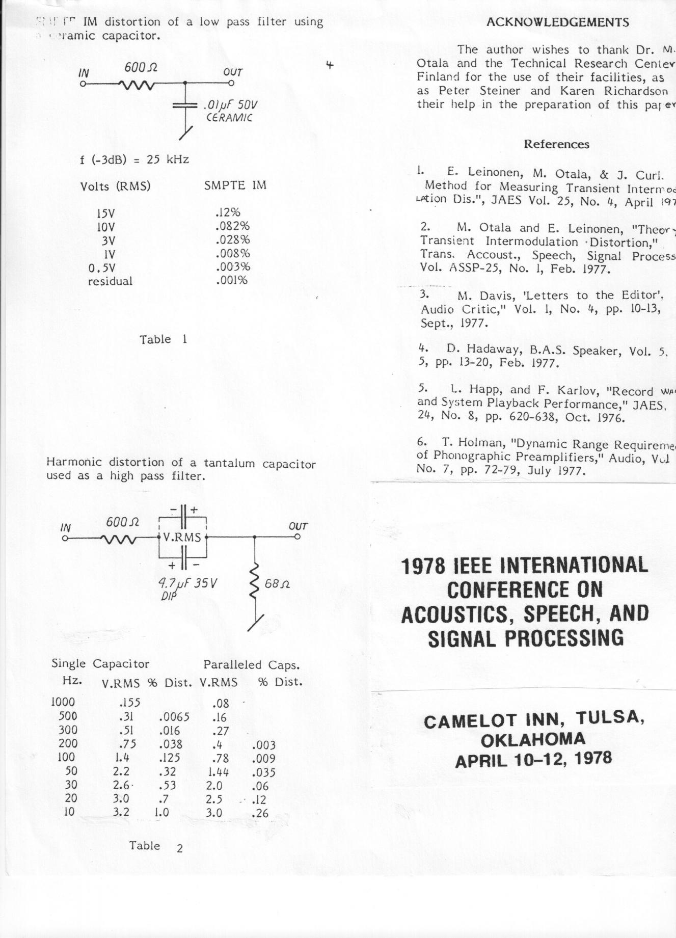

Once, I KNEW that large value ceramic caps were a real problem, I tried to measure them, as well, with more conventional audio equipment, like with an IM analyzer or a wave analyzer. I found that IF I dropped some AC voltage across the cap then both large value ceramics and tantalum caps could show quite a bit of measured distortion. It was just a matter of setting the test frequencies and load resistor so we were at the edge of where the cap actually rolled off.

It is interesting that my two cap distortion examples came from close enough models of HOW we designed amps and preamps at the time. In fact, most of you still design the way we once did, given many examples shown on this website. I hope to open up alternatives to this design approach, like we do today, and not 30+ years ago.

Congratulations BV, you did make great specs with a sine wave.

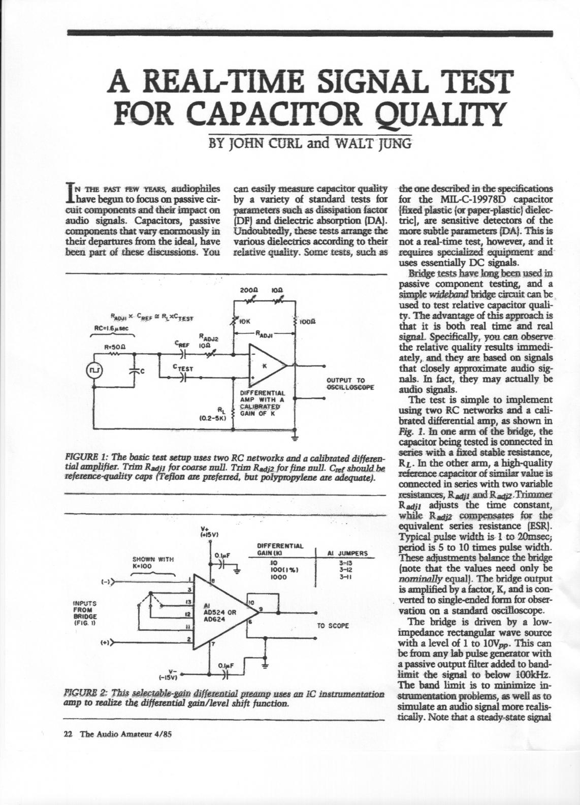

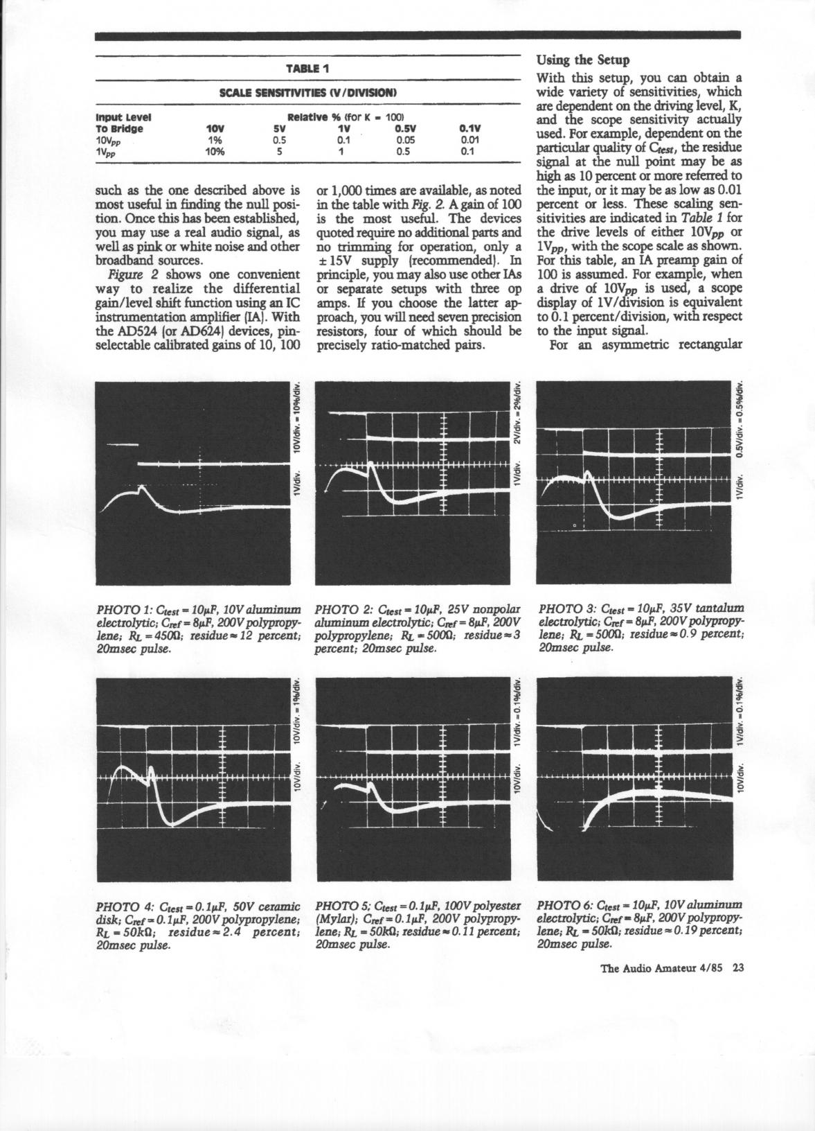

Let's instead, use another waveform that does not look like a sine wave or two.
Let's use a BANDWITH LIMITED PULSE, that is of a fixed duration, asymmetrical, and has a long resting period between pulses. We did a lot of experimenting, yet we found that the pulse length originally selected by Scott Wurcer, was about as good as anything else, better than most, in fact and still within the actual WORKING bandwidth of audio systems.
