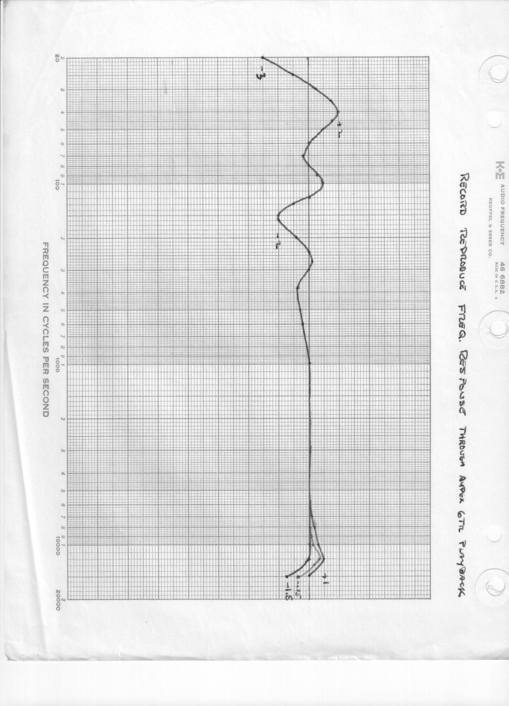

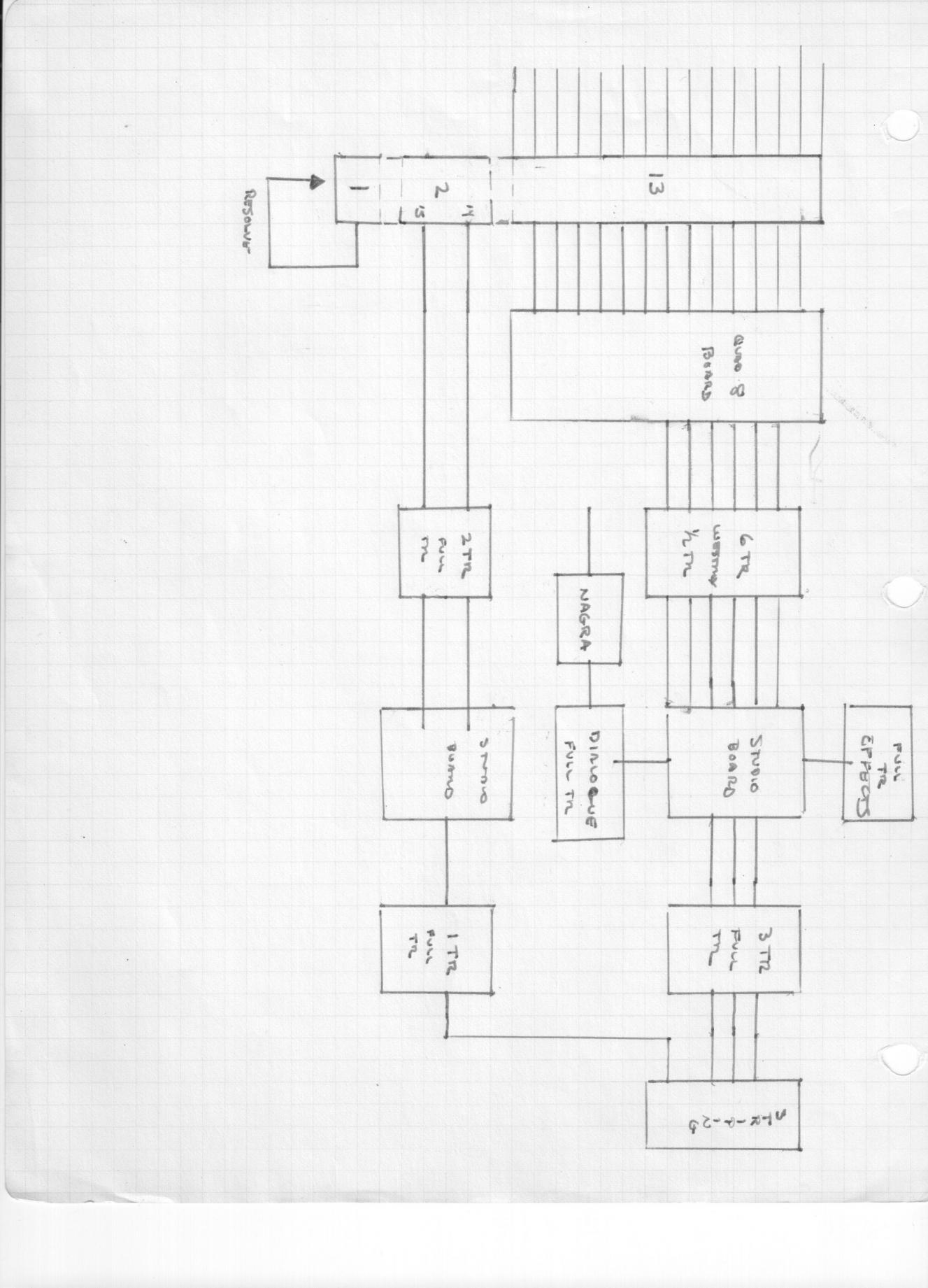

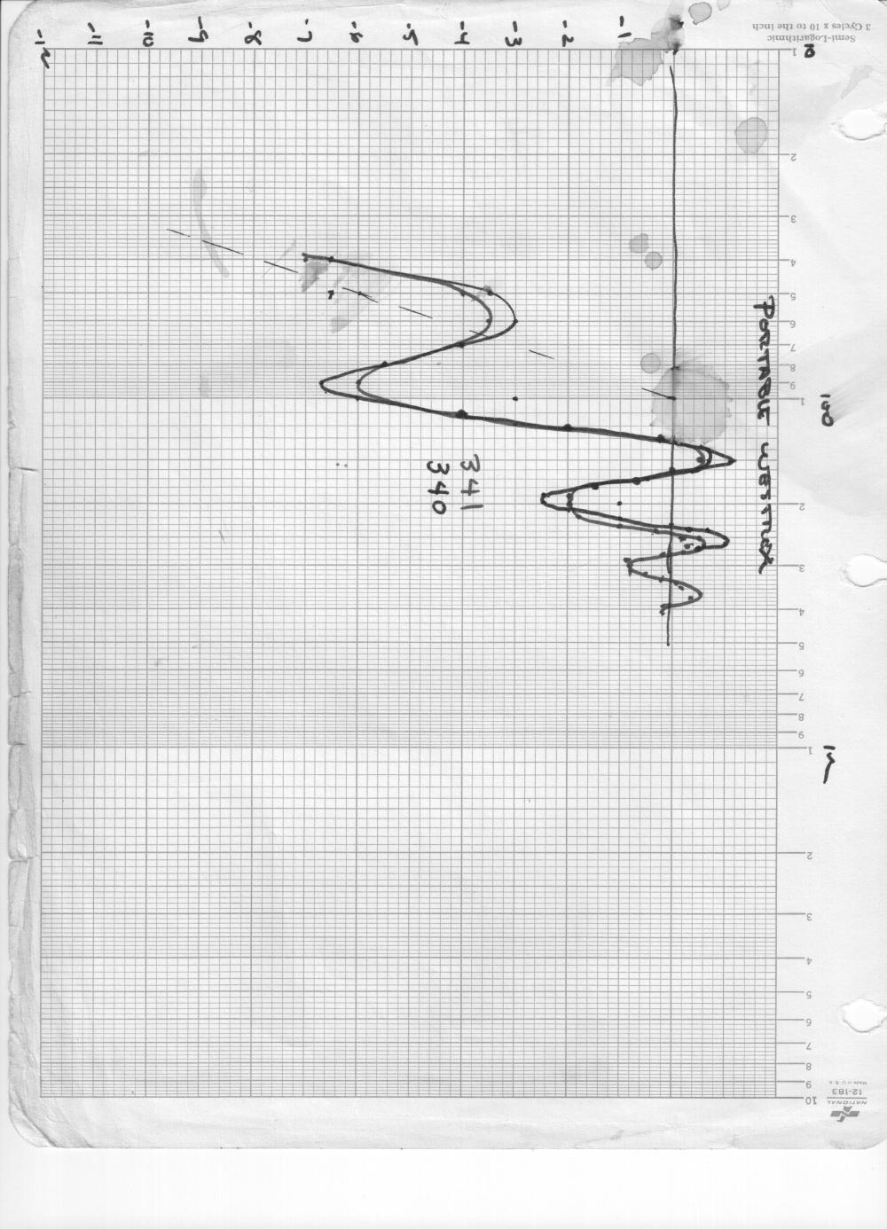

I found some graphs made more than 40 years ago, made while I was working on the film sound track of the movie 'Fillmore'. These were part of my talk at an AES convention 40 years ago. Note that it was not easy to get it right.
