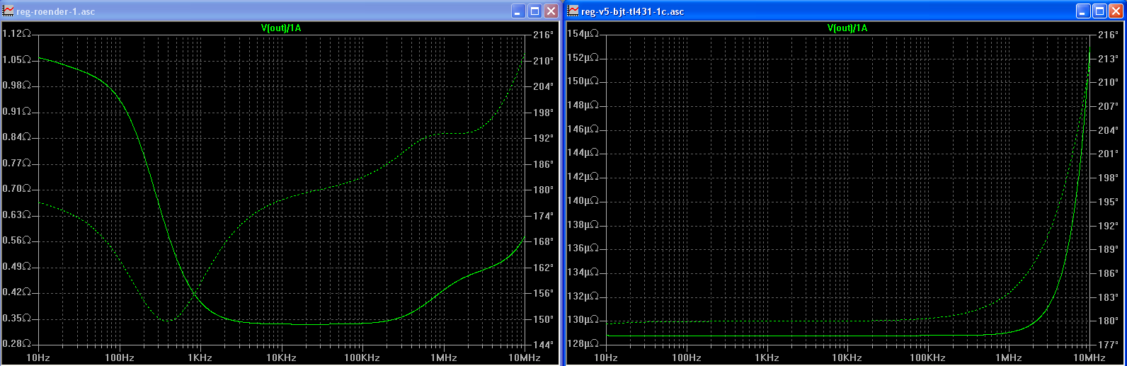

Ah, thank you, it was me indeed! It's the bad way I expressed myself again. What I really meant was that I didn't see one with output impedance that is flat across, with no peaks above 1 milliohm, all the way to 10MHz.
Here's a plot I used a while ago when comparing to some popular regulator: lhs plot is the popular regulator, rhs plot shows what I was trying to say and failed. Obviously, we're in the fairy land of simulators here.
Is this a simulation of the circuit on the left, or the circuit with parasitics (output cap L, ESR, etc)?
Yes, no parasitics considered. Simulation I was asked, simulation I provided. As I said, I have no means to directly measure the output impedance. My estimate is around 10milliohm (in the MHz range), with SMD parts and force/sense wiring.
BTW, your estimate of parasitic reactances you posted a few pages up was 3 orders of magnitude off.

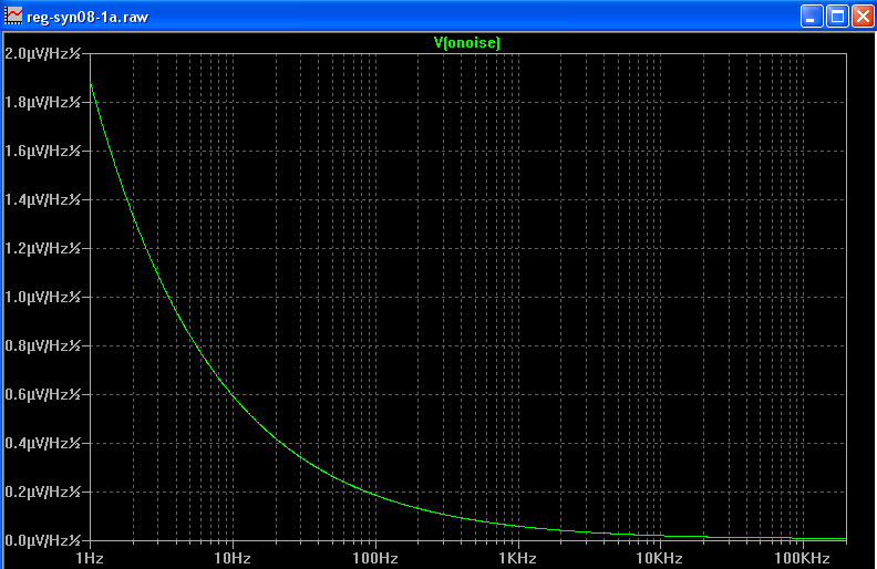

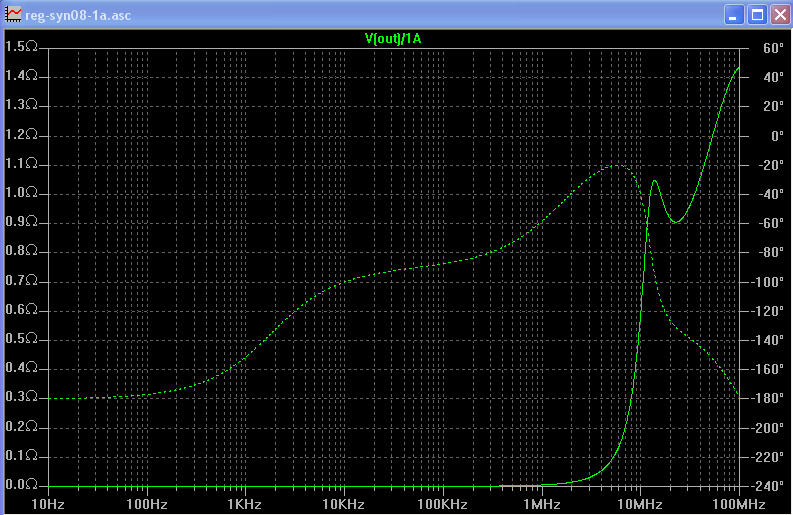

Sorry guys, you're going too fast for me. This is how it simulates for me, the exact circuit you showed, except I'm using lm129 for reference, and all capacitors have parasitics 0R5 ESR and 5nH ESL.
Increasing the gate resistor does not reduce the bump.
I'm using ltspice (too much of a pain to load orcad now), but that should not be a problem. The simulator is set for maximum accuracy (v small tolerance and step size, no compression, etc.).
I'd also like to point out, regardless of these plots, that just because one uses the absolute lowest noise reference in a circuit, it does not mean that the noise a the output of the circuit is very low.
It's unfortunate that I can't simulate John's circuits; it's a bit unfair to syn08, even though he doesn't actually use this particular regulator.
Anyway, please don't shoot, I'm just a beginner trying to understand what you guys are doing and learn from your experience.
Not sure if you are aware of, but that's precisely why I avoid like plague any discussions about simulations. Unless people do calibrate models and simulating conditions, such discussions are going nowhere. Said by a bloke who in another life used to work for Cadence Systems.
Anyway, 0.5ohm and 5nH parasitics are between one and two orders of magnitude larger than those for 0805 SMD parts. FIY, 5nH is the inductance about 1cm of bare, straight wire in free space.

I removed all parasitics. It looks more like your initial plot. I stepped the gated resistor as follows 50R 150R 300R 600R 1200R
Please read the Y axis as ohms, I forgot to divide by 1A.
The bump goes down for a bit, but then it goes up. I would have been really surprised if it was so easy to get rid of that pole, even for experts. It took me weeks to solve this problem. Not that it matters, it's just a simulation anyway, it gets thrown out the window as soon as the solder hits the pad.
For what it's worth, my earlier Zout example was simulated with full exaggerated parasitic ESR and ESL.
On a different topic, my calculations don't exactly agree with yours as far as the noise of the Norton equivalent goes. I have to double check though.
Sorry, I hate being a pain (and so slow), but I think it's in everyone's best interest that we do this carefully.
