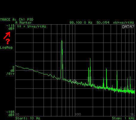

Syn08, on your LED noise plot I see a pek at 60hz (ok, its more than 100dB down, so its pretty low) - is that wiring noise or what?
BTW, 50nV per root Hz is about 7.2uV of 20Hz to 20Khz wideband noise if my calculation is right.
Wiring and relatively high impedance. LM326 has very low impedance (under 1ohm), that's why the 60Hz peak is missing. I could kill all those artifacts by using balanced mode/cabling, but this little experiment is not worth the trouble.
You calculation is correct, and that's about 5% of my Ortofon 0.12mV cartridge. That's how much noise voltage is injected in the gain stage, and it's only the gain stage PSRR to protect against.
-125dB I think. The Led is going to get 5-20mA CCS range from various Jfets. This one is just from 2k7. There are sequel graphs to see I mean, when syn feels like it.
So you translate for the full audio bandwidth. OK. I thought that I lost the graphs because of that -115. Cheers.
P.S. You mentioned 35.7 if extracting the residual. So 35.7*141=5033.7nV. 7/5=1.4 20*log(1.4)=2.92dB. 103+2.92=105.92dB. Even better.

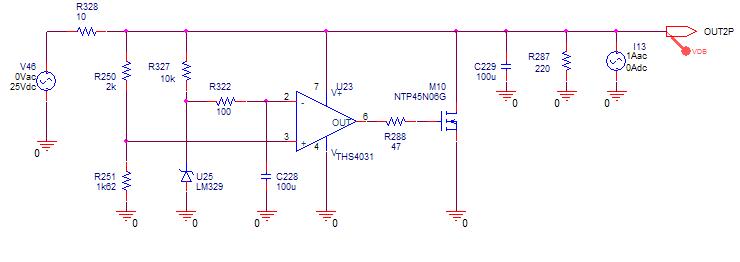

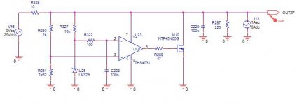

Somebody (I think it was Ikoflexer) said he never saw a regulator with 1milliOhm @10MHz simulated output impedance.
Here's an example I have posted some time ago in another thread. As you see, the output impedance peaks at 5milliOhm at around 1MHz (-40 on the Y scale is 10milliOhm), while it's under 1milliOhm at 10MHz.
I have intensively experimented this parallel regulator, as part of the HPS projects. While I have no means to measure directly the output impedance, I can tell about this regulator as having exceptional performances, if wired with force/sense, to include the PCB traces in the regulator loop. Line and load regulations are measured around -90dB. With the values in the schematic, the output noise was measured at around 100nV/rtHz (and can further be optimized, by using an even lower noise opamp as the new ADA4998, and also tweaking the filter cell around the LM329). It also has 0% overshoot at step load, I've tested this with my HP54720D 1GHz, 4Gs/sec digital scope, down to 50pS resolution.
The one and only reason I decided not to use this regulator in my HPS3.1 preamp was a thermal issue. Under overload conditions, the HPS3.1 head amp deliveres up to 200mA of current in the feedback loop. Therefore, the parallel regulator has to be able to deliver the same current. This led to an unacceptable power dissipation, heating the board and hence... significantly increasing the head amp noise. Certainly, parallel regulators are less than optimum for class AB gain stages.
