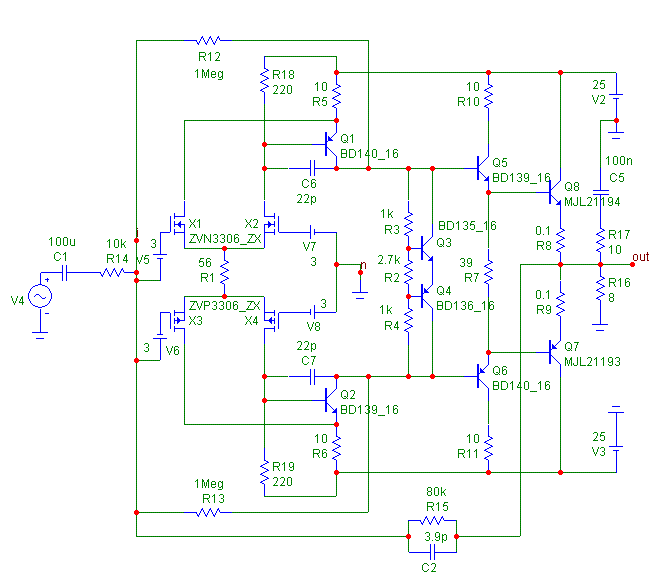

Mike,
You might consider changing the driver stage to Fet to get closer to JC design philosophy. 😀

Guys, do you have some experiences with mosfets on input position ? With really modern types like zvn/zvp 3306 or 3310 ( or similar ), not with old irf 110 ?
Upupa Epops said:Guys, do you have some experiences with mosfets on input position ? With really modern types like zvn/zvp 3306 or 3310 ( or similar ), not with old irf 110 ?
He means input stage with these mosfets, instead of jfets.
If you want linear transconductance characteristics you need at least 300mA through them ... Way to much for an input stage
Pavel (upupa),

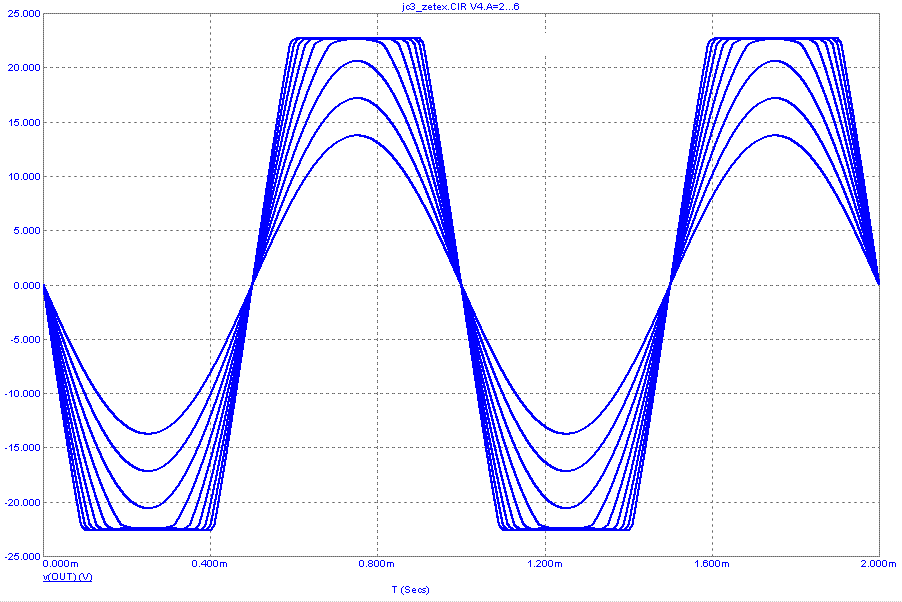

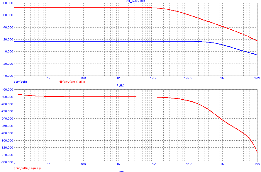

I have library models of these parts. But I am expecting John will draw the bow here .. 😀 😀
.... BUT mosfet input stage itself (not the whole amp) has higher distortion than the jfet one.
