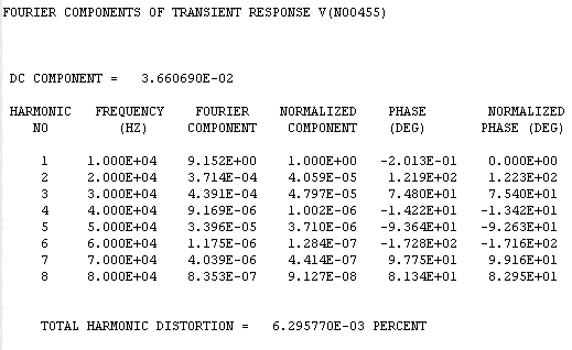

Attached is a schematic for a symmetric folded cascode stage driving complementary MOSFETs directly, as mentioned by JC a few posts earlier. A VGS multiplier was used to set bias. I used the D40D7 ahd D41D7 TO-202 devices for VAS transistors as they are fast and the models were readily available in PSpice. The TO-202 package has 75C junction to ambient thermal resistance, so it can handle a few tens of milliamperes at 20V. I used J113 and J174 for input devices. The input was arranged as non-inverting, but inverting also worked. With the relatively low transconductance of the input stage, no compensation was required. When 2SJ74 and 2SK170 were substituted in the imput stage, compensation caps (22p) were required at the VAS stage to squelch oscillation.
This is an interesting design, but it deviates from my course in several ways. First, why cap input? Second, why starve the output fets? Third, why add 100 ohm resistors at the input of the jfets? Fourth, why change the bias track to an unsymmetrical type and adding a 1uF cap across it? Do you know the price and size of 1 uF Teflon caps?
Also, why 200V fets? How about 60V or 100V fets? Why 330 ohms, why not less than 100 ohms?
Mr. Curl, I read somewhere here that Jfets likes quite big resistor on its input (5K? 10K?). Is this noise related consideration (from datasheets)?Third, why add 100 ohm resistors at the input of the jfets?
And, why you choose inverting topology for JC-3?
In J74, K170, K117 datasheet, the biggest specified Rg=10kohm. Near zero in K117 datasheetYou badly interpreted the 2SJ74 datasheet.
A strange one is K30, in the datasheet it has Rg up to 1M, but the lowest one is 100kohm.
Back to practical amp. Borbely design never use such a big Rg. What's the contradiction here?
Jfets do NOT need input resistors. However, this design could use an RFI filter/impedance defining R-C resistor input of 100 ohms and 100pf on the very input.
I chose inverting topology for the JC-3 to LOWER common mode distortion. With cascode devices on the input, this recent design will suffer from common mode distortion. Just another potential compromise.

Inverting lowered distortion and allowed a PP cap to be used, rather than electrolytic type in feedback loop. The Electrocompaniet was inverting also. It is a minor detail.
