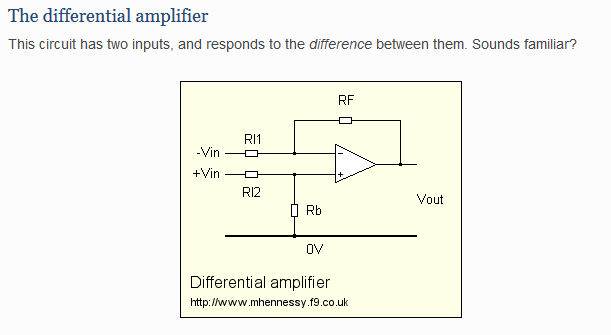

I am totally convinced that what Joe is hearing is essentially an amplifier effect. Lot of sloppy compromises in audio amplifiers, one of the worst of which is poor common-mode rejection. Common Mode is noise from the Earth rail. You can hear it.
The correct condition for optimum common mode rejection is matched ratio resistors in the two arms, but I have rarely seen it correctly done in audio. 😕
Now if you want to continue to ramble on about Ohm's Law, please do. But I use much more advanced ideas like Maxwell's Equations and Shannon's Noiseless Encoding Theorem and Quantum Mechanics. One of my better, if more irritating posts.
