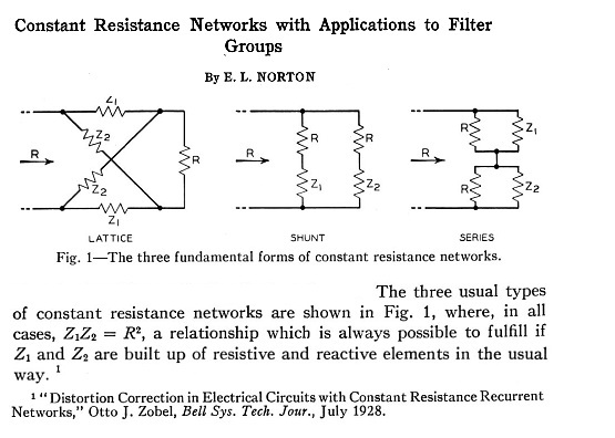

The point may be the same, but it's irrelevant to this thread. What's presented here is:
1. This is a normal speaker system with added impedance correction networks.
2. The flat impedance means that the frequency response doesn't vary much with amp source impedance.
3. This comes at the cost of some wasted power. The networks reduce the efficiency.
4. No analysis has been yet presented showing why using a high source Z amp with this system is in any way better than using a low source Z amp.
5. No actual measurements or listening tests have been presented to show any advantages of the added components and reduced efficiency.

The "distortion" that Otto Zobel was addressing was essentially frequency response and waveform accuracy.
If you look at a modern Rotel RA 931 Class AB transistor amplifier, complete with Class AB crossover distortion, it is one of 4 solutions to the output impedance issue. And we could add Class A to the mix in Nelson Pass style. Or look at John Linsley-Hood's rather good Class A transistor amp from the 1960s. I have heard this one.
It is one of those old-fashioned ideas that you should match the source to the load for some sort of optimum. Ideally resistive. That is what Joe is doing here.

Not really. All he's doing is putting in networks which will cause the frequency response to be independent of source impedance, whether it's low, high, or in the middle. There's nothing special about having it be 2, 4, 5, 8, whatever ohms.
