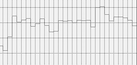

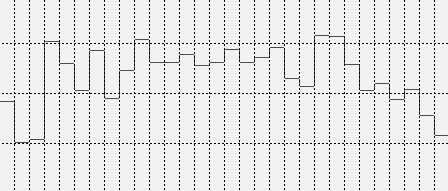

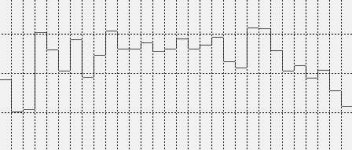

The easiest way to see the effect of a current amp on the frequency response of a driver is a guitar amp: pentode amp with no feedback driving a 12" cone. Add lots of fb and you miss the trebles completely.
The attachments show an CHEAP 8" driver with whizzer cone when voltage driven (left) and current driven (right). Can you see the difference?
